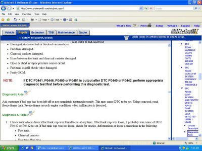

check engine light and vsc light coming on, tis showing a code, PO440 evaporative, emission control system, would like to know how to fix the problem.

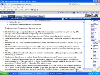

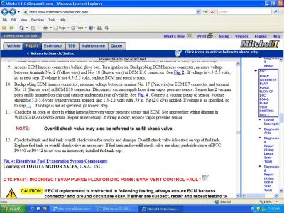

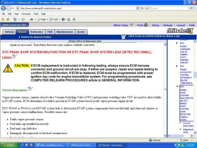

Here is the diagnostice procedure for your code
