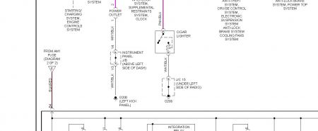

Get a test lite and proble the center contact of the cig socket if you have power check the ground circuit white and black wire from the socket to the ground point G206 at under left side of radio
https://images.2carpros.com/forum/automotive_pictures/12900_cig_1.jpg
