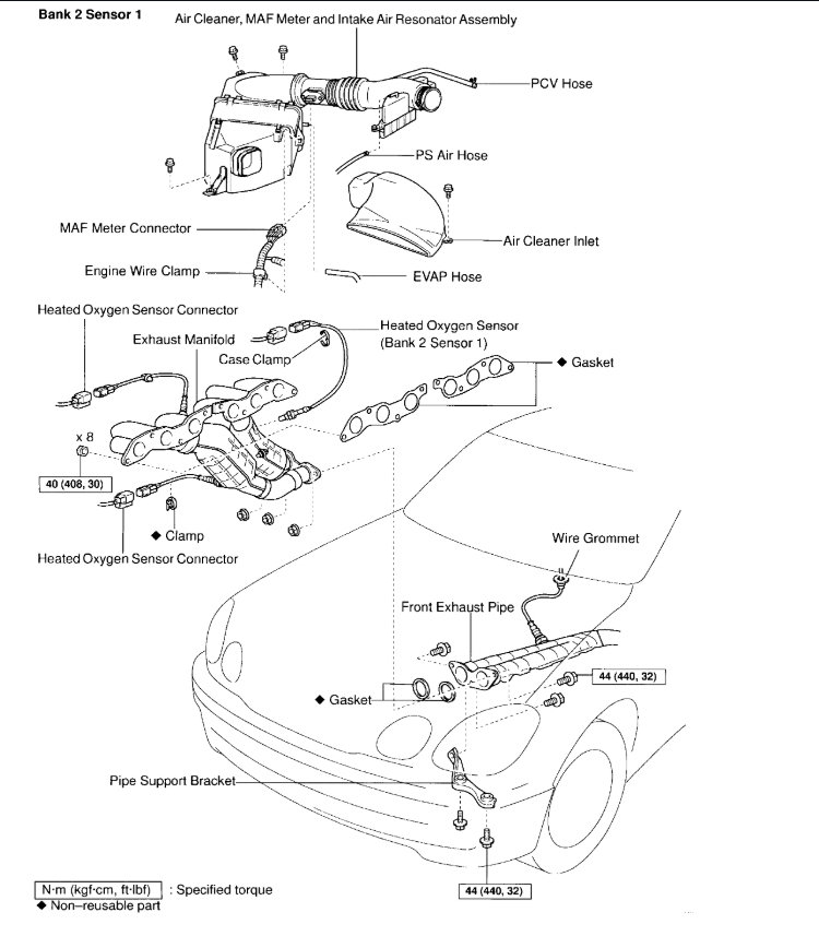

A friend hooked up my '99 ES 300 to diagnose (check engine light is on), the following came up:
Code # P1155 Air Fuel Metering
02 Bank 2 sensor 1
Where exactly is this sensor?
Thank you so much for any help.
Kirsten
Oct 21, 2008 at 2:54 AM
  • 75,992 POSTS
Hi LxsES300 and welcome to 2carpros

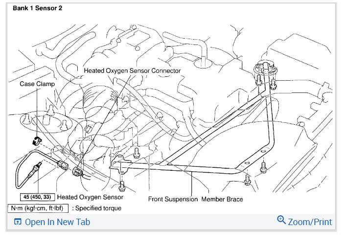

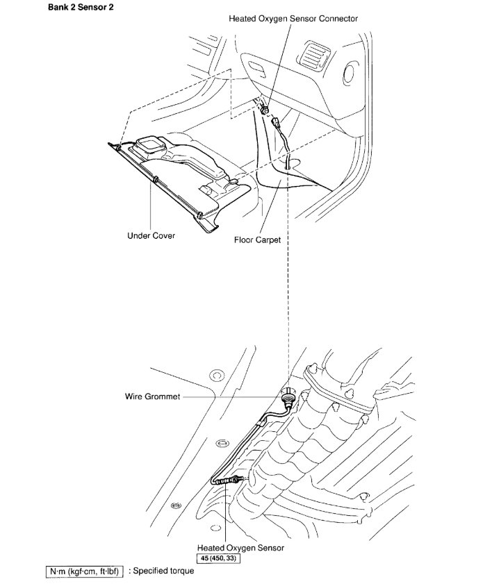

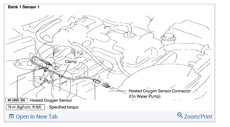

The B2S1 is located on the left exhaust manifold see item location no.13 below and this guide will walk you through the steps with instructions in the diagrams below for your car. Here are all of the oxygen sensor locations. Check out the diagrams (Below). Please let us know if you need anything else to get the problem fixed.
