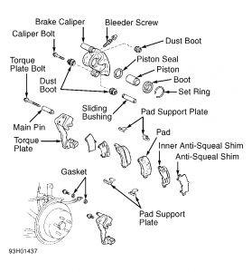

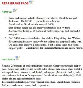

i need to know how to replace the rear brake pads on a lexus es 300. i have already replaced the front.
ps please send photos or diagram.
thanks
