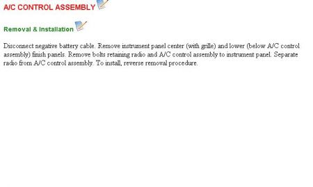

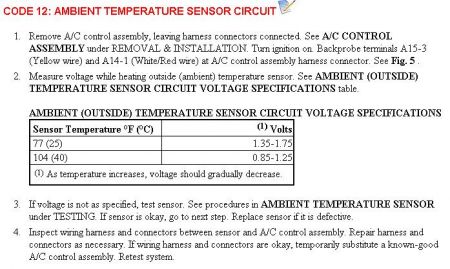

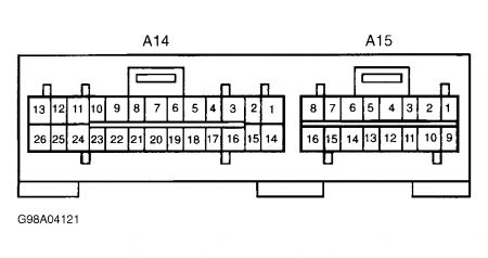

AUTOMATIC A/C-HEATER SYSTEM TROUBLE CODES #12. What does it mean and how do I fix it?

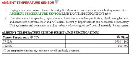

Temperature reads 122F on display, I have tested the Ohms on the Sensor and has a Zero reading (no resistance) Does this mean the Sensor is bad?
Jan 28, 2009 at 1:08 PM
ZACKMAN
  • 4,202 POSTS
Yes, the sensor is bad.
