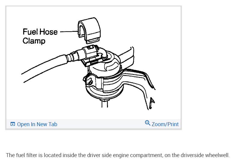

Hello, I'm trying to locate the fuel filter, but not sure where it is. Could you shed some light and direct me to this filter and how I can replace it? Thanks

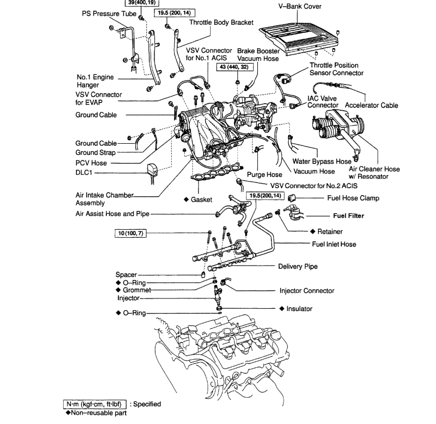

The fuel filter is up by the engine here are diagrams below to show the location and how to change the filter. Check out the diagrams (Below). Please let us know if you need anything else to get the problem fixed.

Where is the location of the fuel filter on my ES 300?

Its up by the engine

where the fuel filter is located on the 92' lexus 300es

See below:
