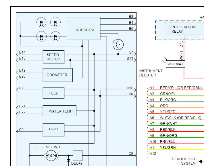

left half of speedometer 0_80 does not light up. The right side and all other lights are working.
Nov 8, 2019 at 10:55 AM (Merged)
Can you get a picture of this and submit it? The reason I ask is I only show one bulb for the speedometer and other components. They are controlled by a rheostat but that only various the resistance to control the amount of current. It doesn't make much sense which is why you are probably why you are asking.
See it may help trigger what this could be with me. Thanks
GAITHER TUCKER
  • 10 POSTS
I removed the instrument cluster and disassembled it. Tested each lamp and found a bad lamp replaced it and re assembled the cluster and now everything is working great. The speedometer definitely has 2 lamps. Thanks for your reply to my problem.
