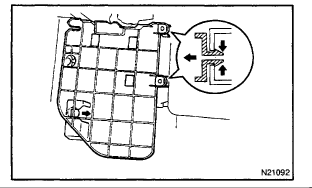

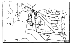

Where is the cabin filter? How do I change it?
Saturday, August 28th, 2010 AT 9:48 AM
MECHANIC
75,992 POSTS
REMOVE AIR REFINER FILTER
a.Release the 3 claws and remove the heater protector
b.Release the 2 claws and remove the filter cover.
c.Pull out the air refiner filter.
