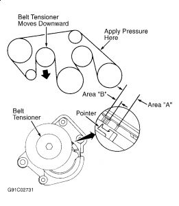

How you change a power streeing belt on this model car 96 lexus es300
Tuesday, October 27th, 2009 AT 8:11 PM
BMRFIXIT
MECHANIC
19,053 POSTS
Raise and support vehicle.
Remove right front wheel.
Remove right lower engine cover
Pull down on the tensioner and remove the belt
