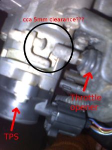

I think this might be the issue. Photo while engine was fully warmed up and idle. Throttle stop screw and stop lever on TB has no clearance. But throttle opener has. Should I unscrew throttle stop screw until this 5mm opener clearance disappear?
https://images.2carpros.com/forum/automotive_pictures/344832_moto_0195a_1.jpg
