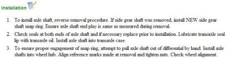

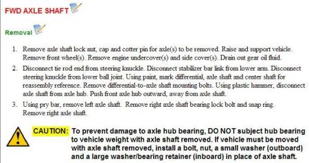

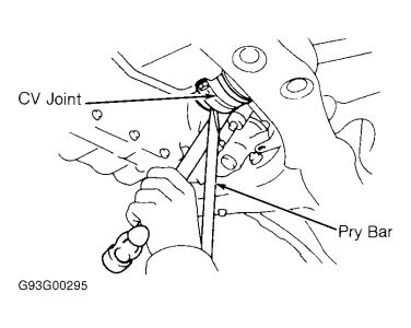

can you send me some pictures on how to replace the axel on drivers side axel for my 1995 es 300 luxus

https://images.2carpros.com/forum/automotive_pictures/261618_Noname_1660.jpg
https://images.2carpros.com/forum/automotive_pictures/261618_Noname2_517.jpg
https://images.2carpros.com/forum/automotive_pictures/261618_Graphic_331.jpg
