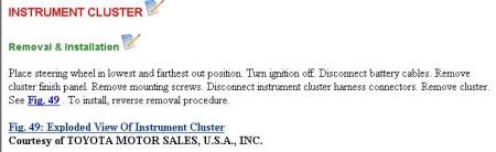

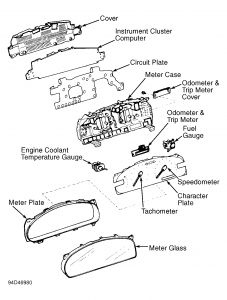

the left side of my dash lights went out, I can not afford to take it to the dealer so a friend will look at it.how do we fix this, please help i am as they say a senior citizen lady that needs help the cheapest way out.

https://images.2carpros.com/forum/automotive_pictures/55316_95es300_1.jpg
https://images.2carpros.com/forum/automotive_pictures/55316_95es300_2.jpg
