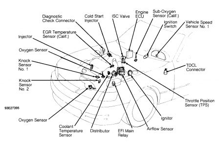

Hello .. thanks for the donation .. much appreciated Try this couple of test's and let me know your results .. #1 speed sensor on ES300 is located on the rear of instrument cluster .. let me know Vehicle Speed Sensors (VSS) No. 1....In speedometer assembly. See Fig. 3 . No. 2....On right side of transaxle housing

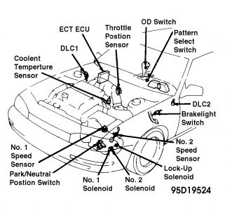

Vehicle Speed Signal Vehicle speed signal is delivered to ECT ECU by No. 1 and 2 speed sensors. The No. 1 speed sensor is driven by differential and indicates actual vehicle speed. The No. 2 speed sensor monitors (magnetic pulse signal) the drive pinion speed.

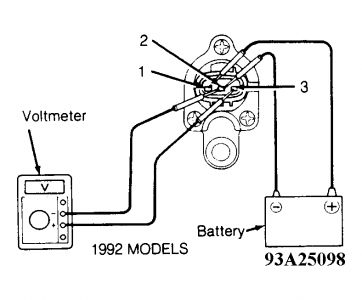

NO. 1 VEHICLE SPEED SENSOR (VSS) TEST Disconnect electrical connector from No. 1 VSS, located on top of transmission. See Fig. 1. Connect positive battery lead to terminal No. 1 and negative lead to terminal No. 2. Connect positive lead of voltmeter to terminal No. 3 and negative lead to terminal No. 2. See Fig. 21. Raise and support one vehicle front wheel. Rotate wheel and monitor voltmeter. Ensure voltage changes from zero to 11 volts. Voltage should change 20 times (1993 Camry) or 4 times (1993 ES300) per each revolution of speedometer cable shaft. Replace speed sensor if voltage dose not change as specified. Fig. 21: Checking No. 1 Vehicle Speed Sensor (VSS) Courtesy of TOYOTA MOTOR SALES, U.S.A., INC.
