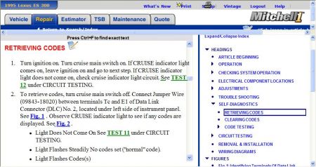

1995 Lexus ES 300 CRUISE CONTROL INOP
1995 LEXUS ES 300
12,200 MILES • 6 CYL • 2WD • AUTOMATIC
BCUSNAVY
WHEN I TRY TO ENGAGE CRUISE CONTROL, THE "CRUISE" LIGHT ON THE DASH FLASHES, BUT IT NEVER ENGAGES, AND AFTER ABOUT 5 FLASHES, THE LIGHT ON THE DASH GOES OUT.
Oct 23, 2008 at 6:00 AM
  • 75,992 POSTS
Hi BCUSNAVY and welcome to 2carpros Try pulling the code/s from the cruise control computer located at right side of instrument panel Check the stop fuse 25amp, Brake switch and Cruise control Actuator-
