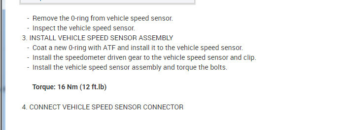

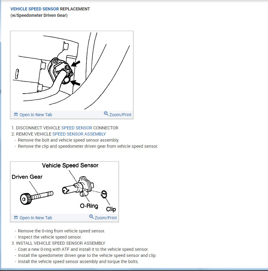

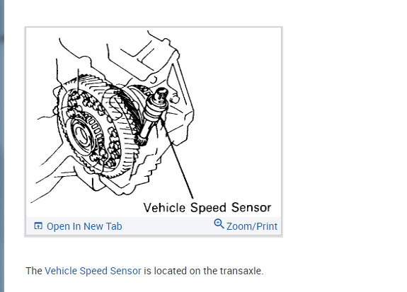

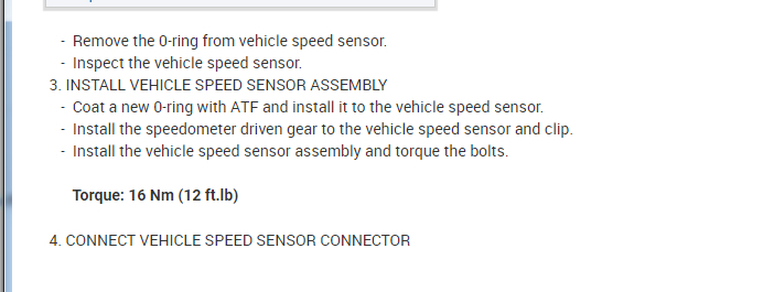

where are the sensors located that deal with the speedometer and transmission shifting?
Aug 31, 2010 at 12:02 AM
I am attaching the information on the vehicle speed sensor which is near the CV axle outputs in the transaxle. I would agree that this is most likely the issue.
Take a look at this material and let me know what questions you have. Thanks
