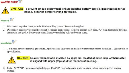

i need complete directions on changing the water pump

https://images.2carpros.com/forum/automotive_pictures/261618_Noname_2706.jpg
