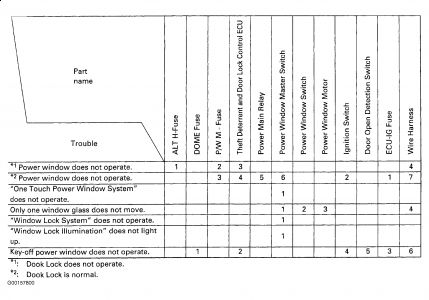

all my power windows door locks windows and power seats don't want to work checked all fuses under hood and iin the interior both drivers and passenger floor sides and relays what am i missing?

start by checking 30amp power fuse in left side dash fuse box ..

yes i have checked 30 a fuse in drivers side fuse box
also checked all fuses under hood as well as fusible link and relays. also checked both fuses and relays on driver and passenger kick plates and nothing seems to be out of order open to any and all suggestions

The only thing the door locks/windows and power seats have in common is the 30 amp fuse and wiring .. did you check the fuse is getting a hot feed from battery ?
