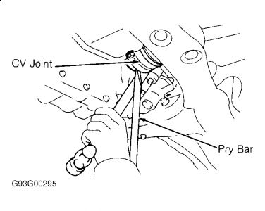

How do I get the inner axle out from the trans. It has a carrier bearing thats housing is a motor mount ?
Mar 25, 2010 at 10:54 AM
DOCFIXIT
  • 18,828 POSTS
Hi The right side correct?
https://images.2carpros.com/forum/automotive_pictures/198357_Graphic_416.jpg

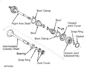

Have you removed tie rod, stablizer link and streeing knuckle from lower ball joint and removed axle shaft from hub? if yes then remove bearing lock bolt and snap ring. Then pry axle from trans as in diagram
