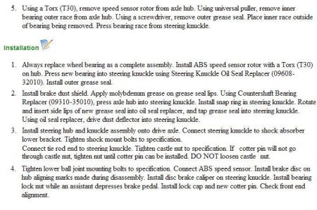

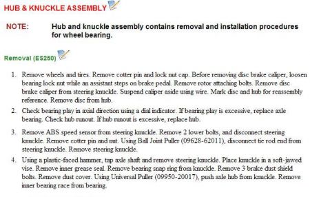

1991 Lexus ES 250 150000 miles
how to you change a wheel bearing in the drivers side front tire
