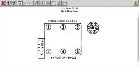

I need to know which plug wire goes where. Fiiring order and which connection on the distributor each connects to.

Hi tulsahawk823, Welcome to 2carpros and TY for the donation -see below
