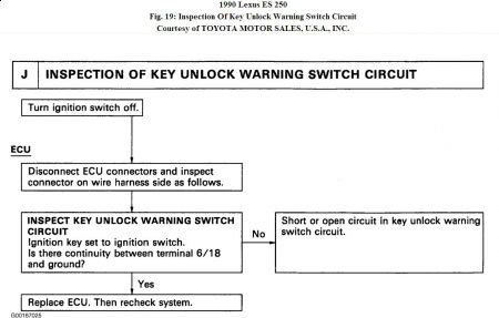

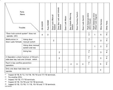

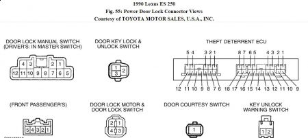

when unlocking the driver door the alarm goes off. but on unlocking on passenger side OK so we open on passenger side

By symptom I would first start my testing at the LH door lock control switch and the door lock key switch. Might be wiring or component failure.
I can provide some testing information if you are going to do the testing. IF you decide o take it to a shop, they will already have the info.

when unlocking the driver door the alarm goes off. but on unlocking on passenger side OK so we open on passenger side[/quote:dedcee5a13] we allready change the switches the door lock still the same problem.

What switches did you replace, and what else has been done regarding this problem?
Oct 26, 2009 at 8:43 AM
DEANMENDEZ
[quote:32b851764e="Service Writer"]What switches did you replace, and what else has been done regarding this problem?[/quote:32b851764e]
I replace the door key lock with the to switches on it
the door lock switch has to wires coming out of it.
That is all i done.

https://images.2carpros.com/forum/automotive_pictures/30961_1lex_1.jpg
https://images.2carpros.com/forum/automotive_pictures/30961_1lexj_1.jpg
https://images.2carpros.com/forum/automotive_pictures/30961_1lex2_1.jpg
