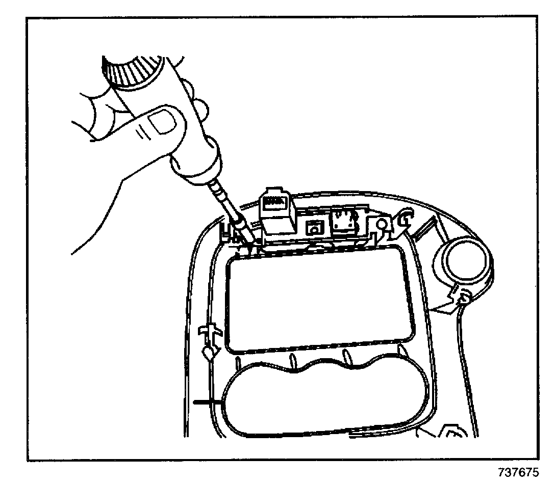

Hello, I changed the front and rear (bulbs) and change fuses but neither do? Where is the flash of directional?
Sep 4, 2019 at 12:25 PM
  • 110,244 POSTS
Welcome to 2CarPros.
Did you notice if both front and rear lights are flashing? As far as the directional flasher, both the hazard and turn signal flashers have been integrated with the hazard switch. So the switch will need replaced.

1. Remove the Instrument panel accessory trim plate.
2. Remove the screws from the switch retainer bracket.

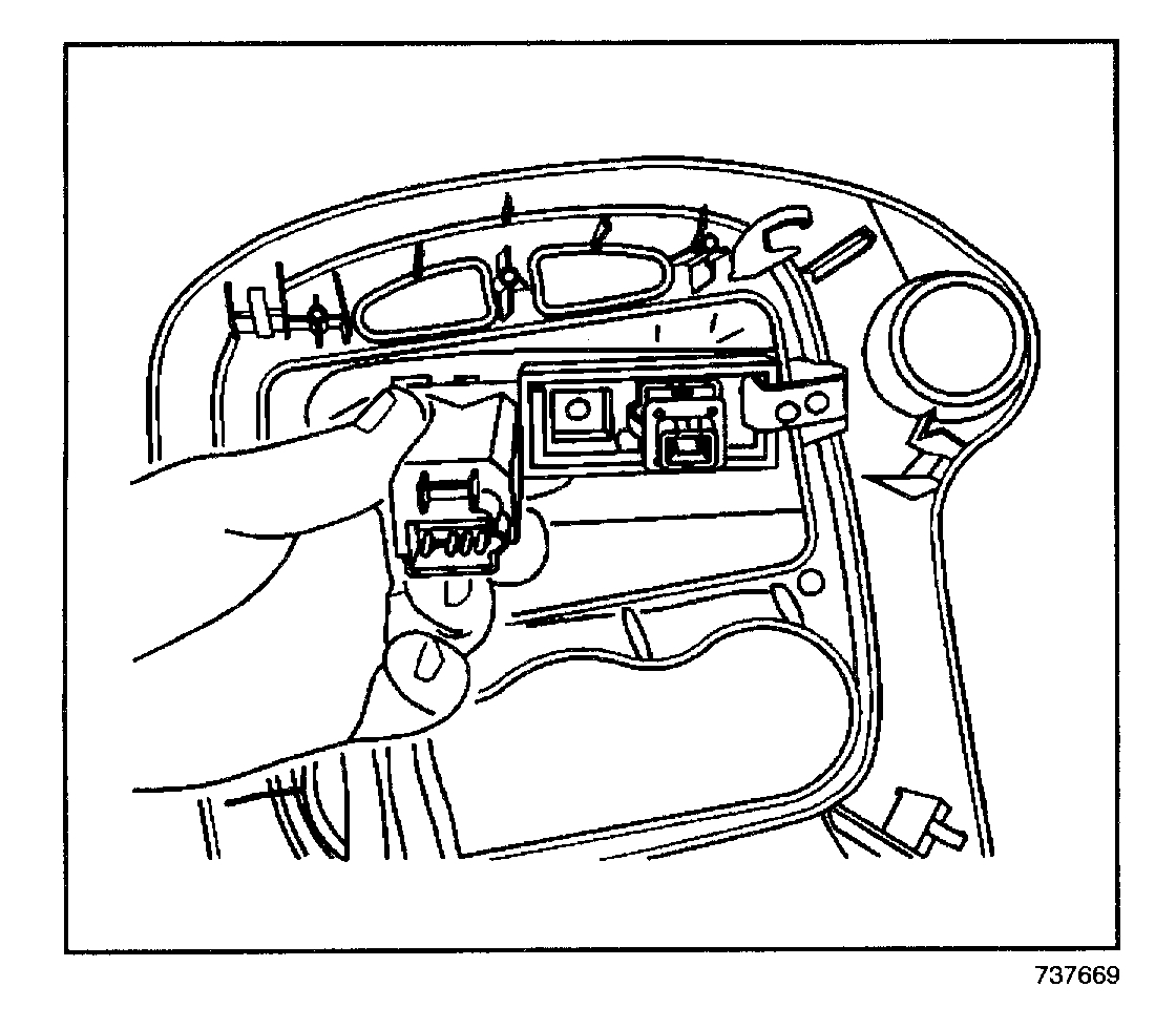

pic 2
3. Remove the retainer bracket from the accessory trim plate.

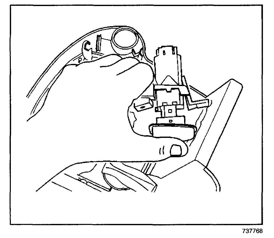

pic 3
4. Remove the flasher and switch from the switch retainer bracket use a small flat-bladed tool in order to depress and release the flasher retainers, while pressing the flasher and switch out with your thumb.

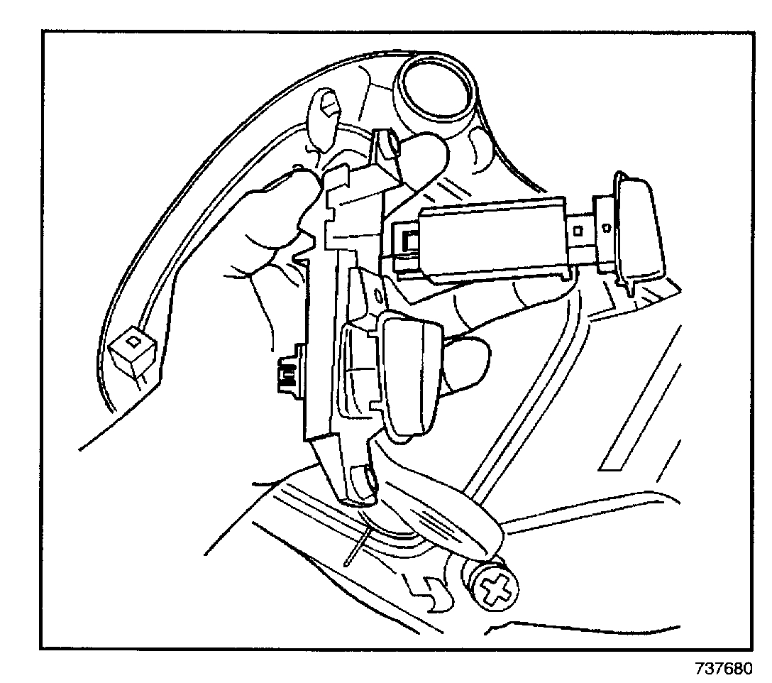

pic 4
5. Remove the flasher and switch from the switch retainer bracket.

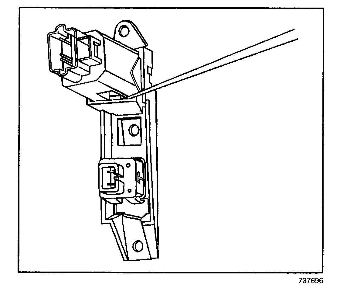

INSTALLATION PROCEDURE
pic 5
1. Position the flasher and switch to the switch retainer bracket.
pic 6
2. Install the flasher and switch to the switch retainer bracket pressing into place until fully seated.
