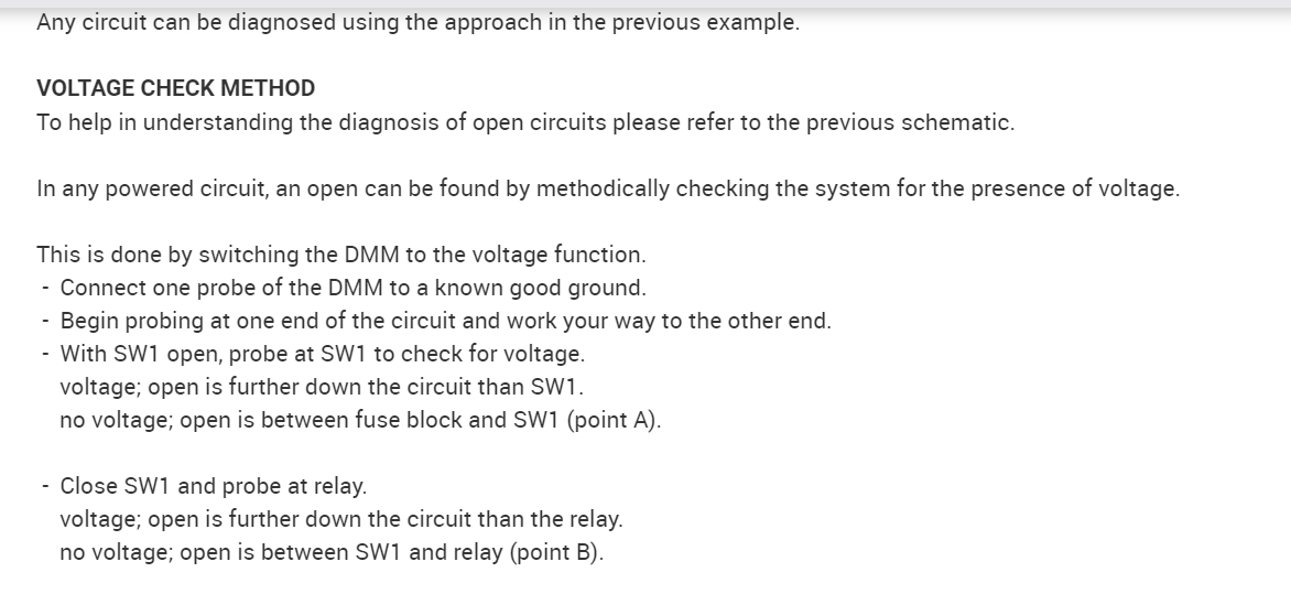

Can you double check the bulbs and make sure that they are securely plugged in. This is what happens when a bulb is blown out, or there is a n open in the circuit. In the diagrams down below I have included a guide for how to find an open in your external lighting circuit. Please go through this guide and get back to us with what you are able to find out.

Jul 28, 2019 at 10:01 PM
ENAZI
This is very helpful!
Thanks a lot.
