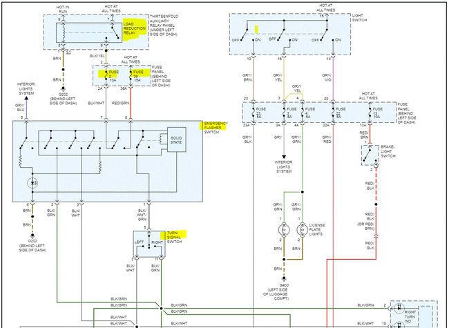

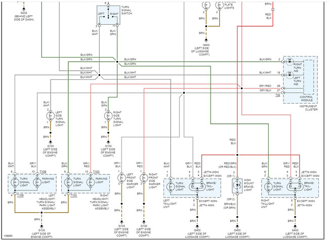

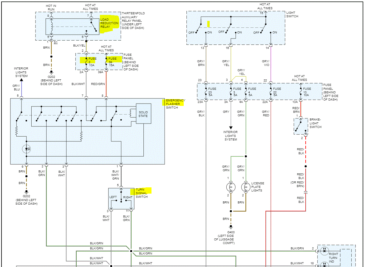

I attached a wiring schematic below of the exterior lighting circuit. There are two fuses I need to know about, fuse 2 and fuse 39. Both are located in the fuse panel in the vehicle, left side under the dash.
Which one blows when you turn the hazard lights are turned on? If it is fuse 2, chances are there is a problem with the load reduction relay. If it's fuse 39, then we have an issue that is likely related to the hazard switch again. When you replaced the switch in the past, did it take care of the issue and then return?

Thanks Joe for your response, the fuses are both okay in this situation when the emergency signal pack up. I discussed with the technician he said the issue has nothing to do with the fuses.

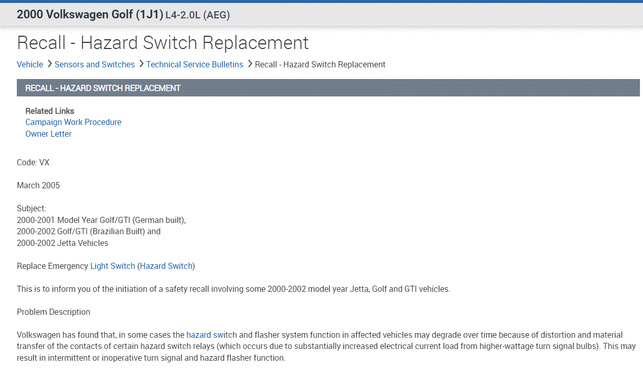

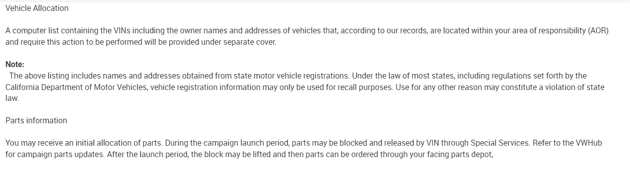

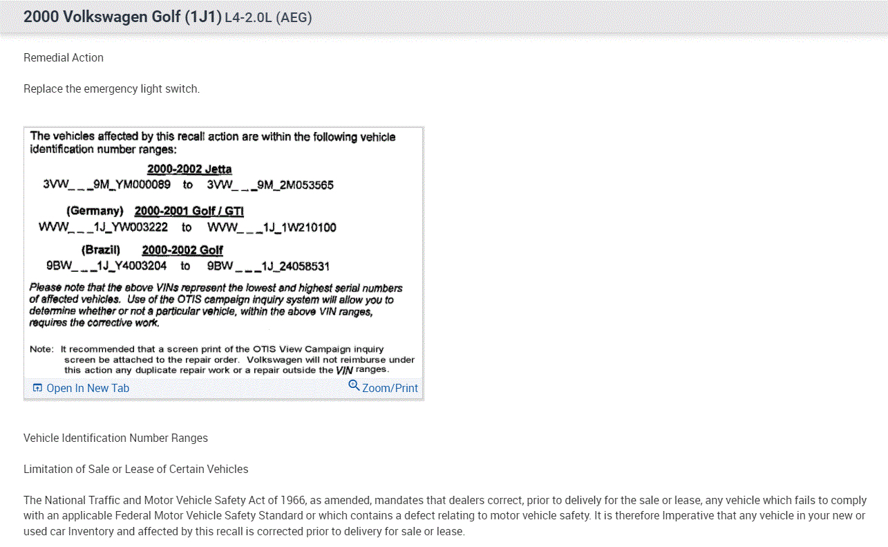

  • 110,240 POSTS

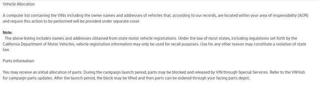

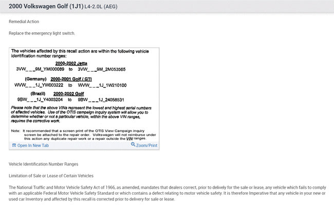

I misunderstood. Interestingly, there was a recall related to the flasher due to component degrading over time causing a distortion of material.
Do you know if the recall was ever addressed? I attached a copy of it below for your review. The one thing that has me concerned is the fuse didn't blow. Instead, the switch burned up. The recall references the switch, but often times it is related to connectors.
