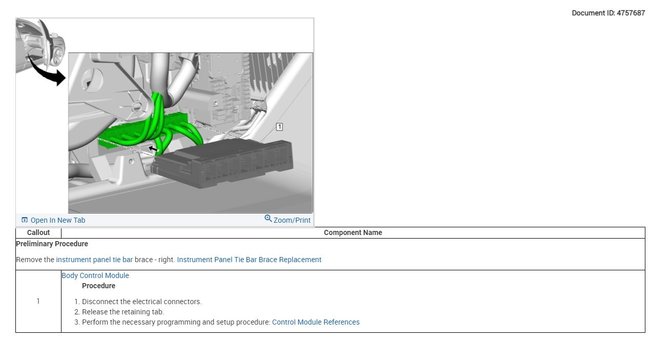

My left turn signal will start blinking normally when used, then after 3 seconds it begins blinking rapid like a bulb is burnt out. I have checked all 3 bulbs (front, rear, and mirror) and none are burnt out. I was wondering if anyone could help me find which fuse or relay commands the Left turn signal so that I can check those before replacing bulbs. Again, all bulbs appear to function properly.

The body control module controls the speed and operation of the turn signals.
If there is a fault, there should be a code stored. It will not show up on a standard code reader. You need one that will read codes for the BCM.
It could just need an update, or it may have to be replaced.
