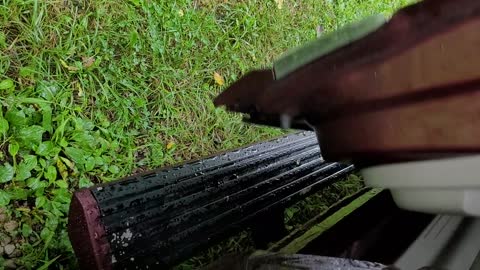

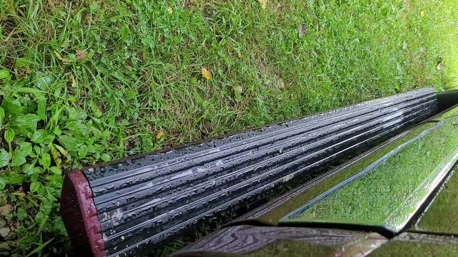

Installed new kit from ebay. Motor both brackets and rod that runs between front and rear bracket. Deploys down and flat with door open. Only goes up a few inches with door closed. Nothing in brackets to block movement. Doesn't go back down like something is blocking it. Just stops. Also when driving truck when stopped and start to move again the board will go down and up again.

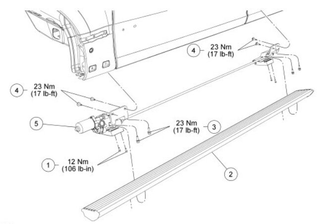

So, this is an aftermarket kit not OEM correct? That can be the problem, here is how the OEM unit is installed. The system is run by the power running board module and switches inside the motors so the problem must be with either of them, I would say the problem is in the lift motors. Check out the images (below). Please upload pictures or videos in your response

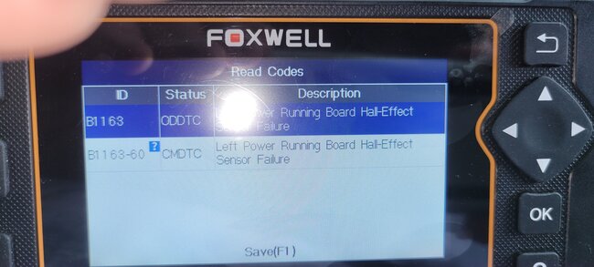

This is what my code reader said after testing modules. I am reading the 60 on
Second code indicates short in module. Would like your opinion. Thanks again for your time.

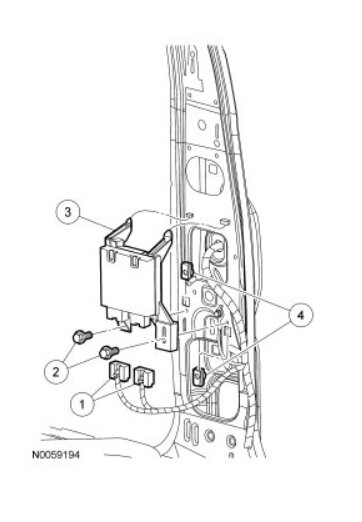

The hall effect sensor is inside the motor. But you said you try a different motor so the controller must be not working correctly. I would swap it out, here is the location on the left side. Check out the images (below). Please let us know what happens.
Aug 18, 2025 at 3:37 AM

Yesterday I got out of truck. Closed front door. Opened back door pulled something out and closed back door. Put thing down turned back to truck and running board was all the way up. Opened front door came part way down. Each time door was opened it would go down little more but not go up fully. After 4 or 5 cycles it was fully out and only going up part way. Don't know if that helps or hurts.

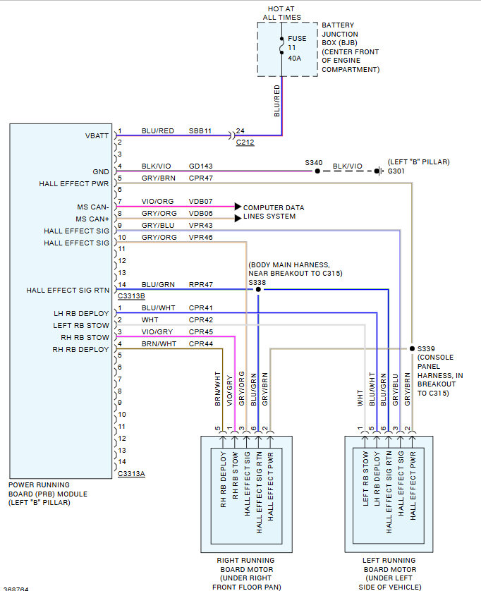

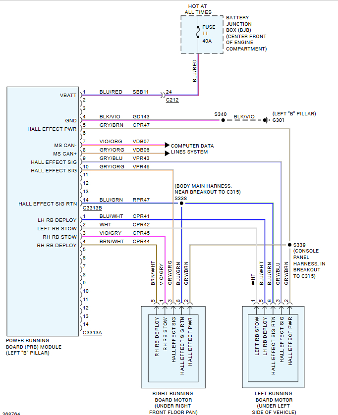

It does not look like any programming is necessary so it must be the wiring since you replace the other components. Here is a guide to help check it and the system wiring diagrams below.
Check out the images (below). Let us know how it goes

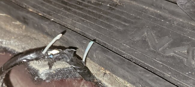

So after much nashing of teeth and grumbling under our breath we found this under carpet at spot your foot rests when you are driving. Got to love engineers. It is the hall effect signal wire. Splice wire and all works as it should. Thanks so much for your help
Aug 23, 2025 at 11:17 AM
  • 55,433 POSTS
Yep, that will do it, great find! That why I love cars, they can always be fixed, please use 2CarPros anytime we are here to help.
