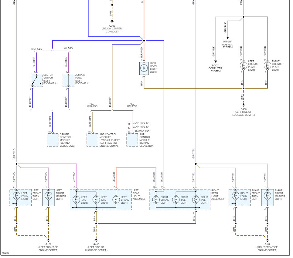

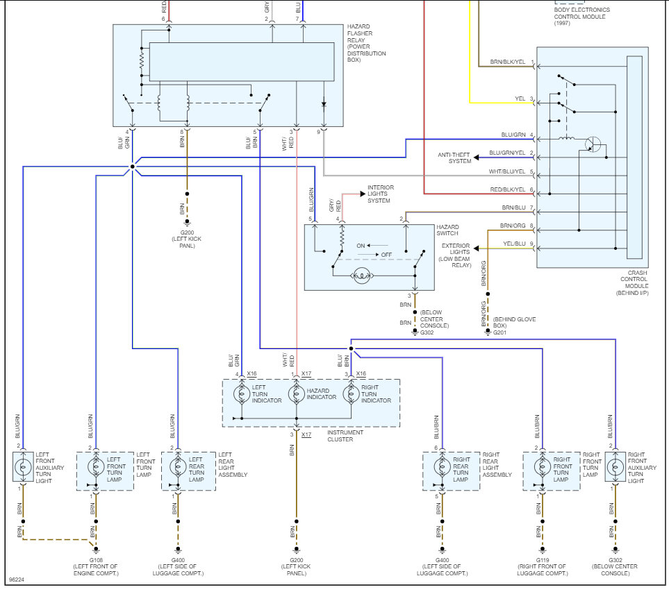

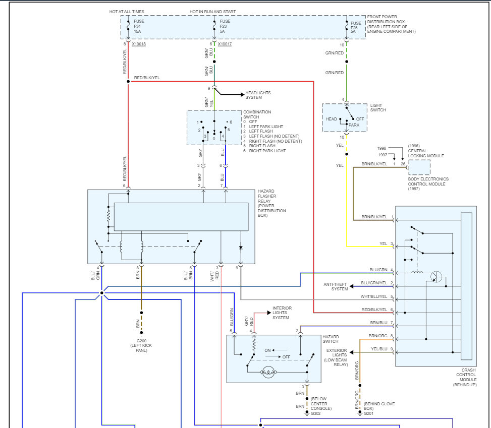

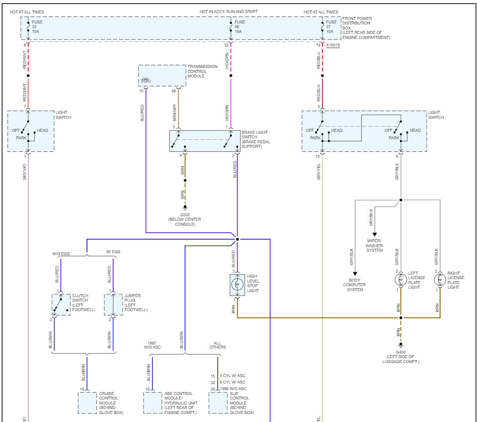

Front/rear left side parking lights and front left corner lights don't work. All fuses tested. swapped fuses 33 and 37 (left and right-side parking lights for) no change. Is there a separate relay for parking lights? American market car. Could headlight switch be the culprit? Flasher's work. Bulbs all checked and good.
Jun 1, 2023 at 4:31 AM
  • 55,694 POSTS
It could be the switch, or you don't have power at a fuse, this guide can help you check for power to see where you are losing it at. Also, I have included the turn signal wiring diagrams below.
