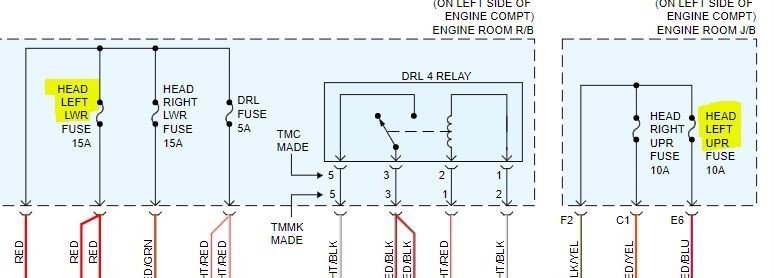

Hi there,
The left side headlight went out a few months ago, figured it was the bulb, and no problem. Got home, and found the bulb and fuse are both okay. Other headlight works fine, so don’t think it’s the relay (unless they’re both on separate ones?) A new socket was installed by previous owner, which had melted, so I pulled that and the butt crimps and replaced both, still to no avail. I’m getting 12v across the wires. Any ideas on how to diagnose where the issue is? Thanks in advance.

If you are getting 12v to the light socket, the bulb is good, and there are no connection issues with the plug, then it has to be a ground related problem. Since you have power, a fuse is unlikely, but each beam and side has its own fuse. See picture 1.
Next, I need you to check for a good ground to the left light. See pic 2 for location.
