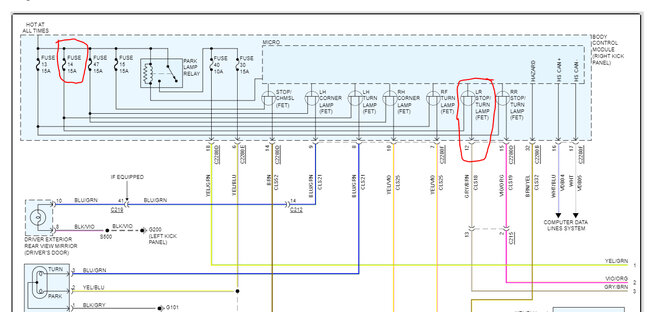

My left rear turn signal/brake doesn't work. Replaced bulbs and checked all fuses and relays. The front left works so I don't think it is the multi-function switch because I have read that it just does each side not each corner individually. I have also read that it could be the BCM. I bought a code reader and don't have any codes. I disconnected the battery to reset ECM. one question I have is if the top bulb or socket is bad on the rear left, does the bottom not work? The other question is, will a faulty BCM always give a code?

No power to the lights. I have an appointment 4/5 to get it diagnosed at a local mechanic. I checked the plugs near hitch receiver and above the spare tire and couldn't find anything.

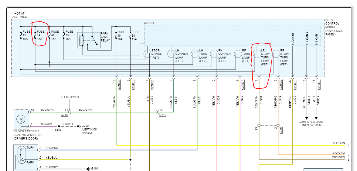

Okay, if the front work, fuse 14 at the body control module is good. However, there are two different wire feeds to power the front and the rear.
At the body control module, there is a gray wire that feeds power to the left signal and brake lamp. (See pic 1) We need to check if there is power present there for the two lamps. If there is, then we have an open circuit between the BCM and lamp assembly.
Let me know if this is something you feel comfortable doing. Hopefully, we can save you the labor bill on the 5th.
See pic below.
