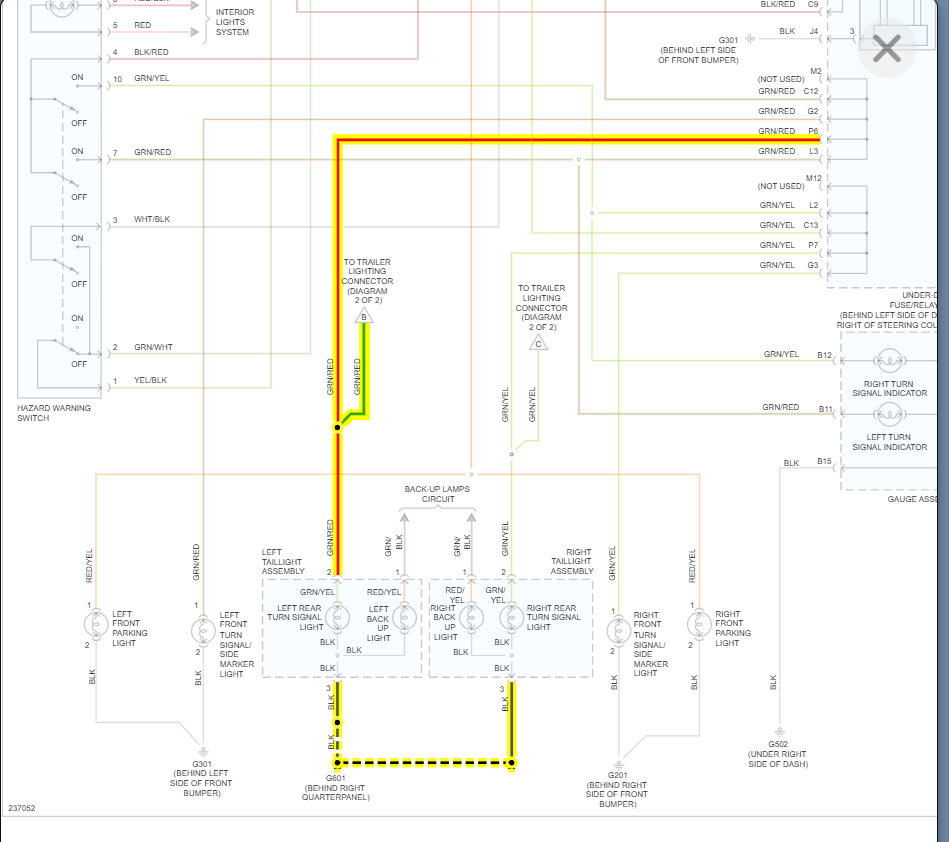

I have changed all the bulbs and still no lights work all other lights work on the car. But nothing in the left taillight assembly works.

We need to check the voltage that is getting to the rear taillight assembly to see if there is anything there.
Here is a guide that will help with this:

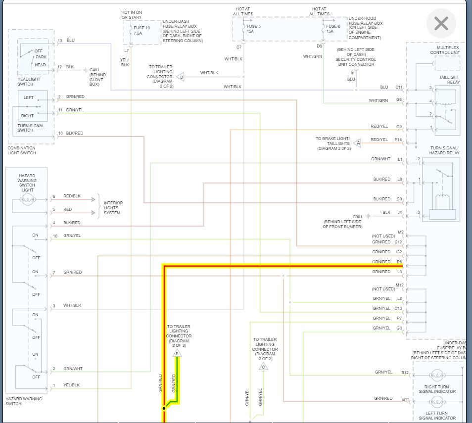

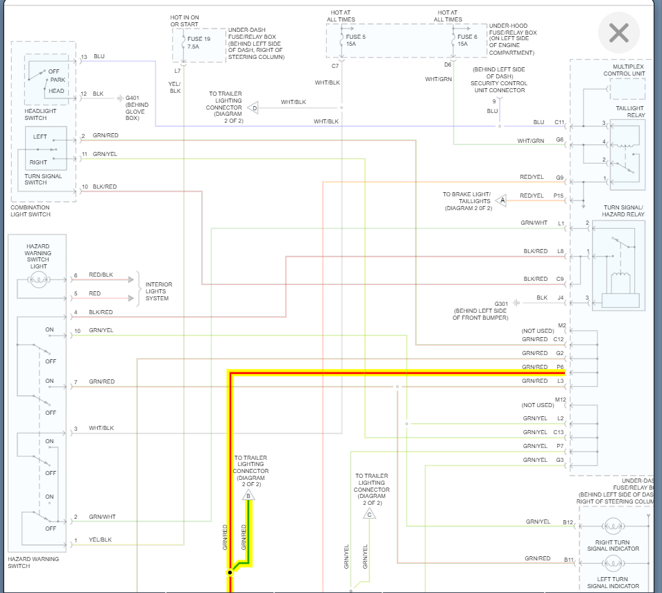

I am attaching the wiring diagram below as well that will help with this. However, you have a single wire coming in that we need to check when you have the lights turned on.
It is unlikely that this is a ground issue since it appears they are shared ground for the rear lights so let's start with checking what is there, and I am sure we will find a wiring issue or a fuse block issue.
Let me know what questions you have.
