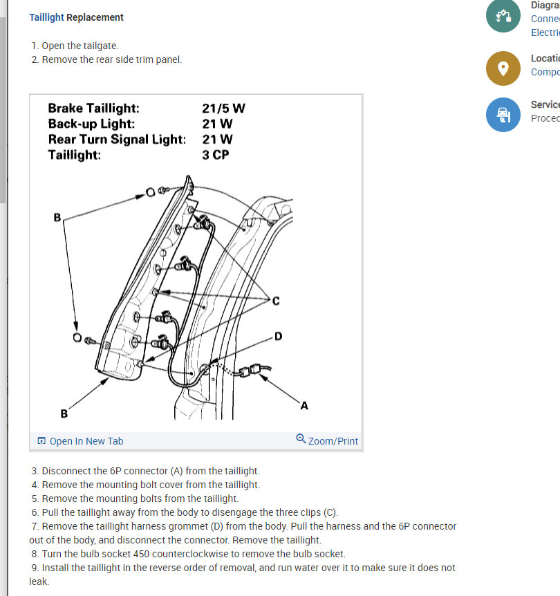

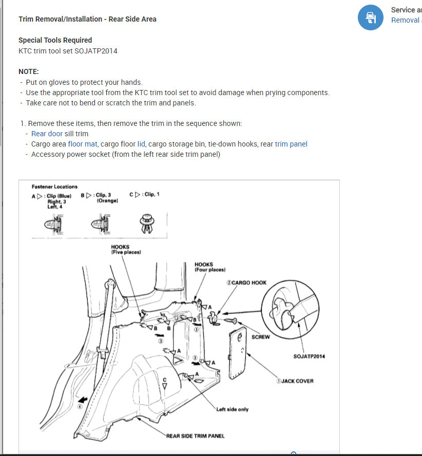

Need to replace entire rear tail light assembly. I can remove the assembly but it appears that the electrical connector is inside the body of the car and I don't know how to access it. Do I need to remove the bumper or what. I bought a new assembly thinking I could replace it myself but not sure now.
May 27, 2009 at 10:33 AM

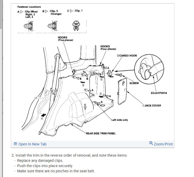

I am attaching the info from the manual that will help with replacing this info.
I am attaching the info below but here is a guide that will help with this info:
https://www.2carpros.com/articles/brake-lights-not-working
Please see the info below from the manual.
