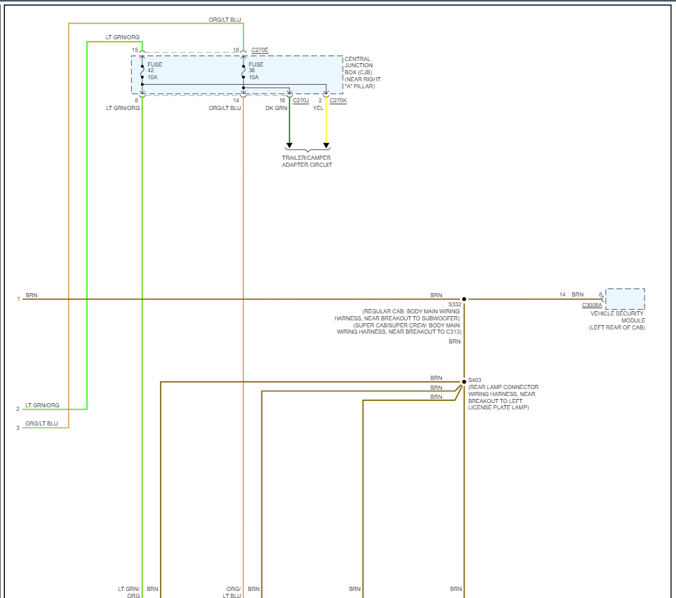

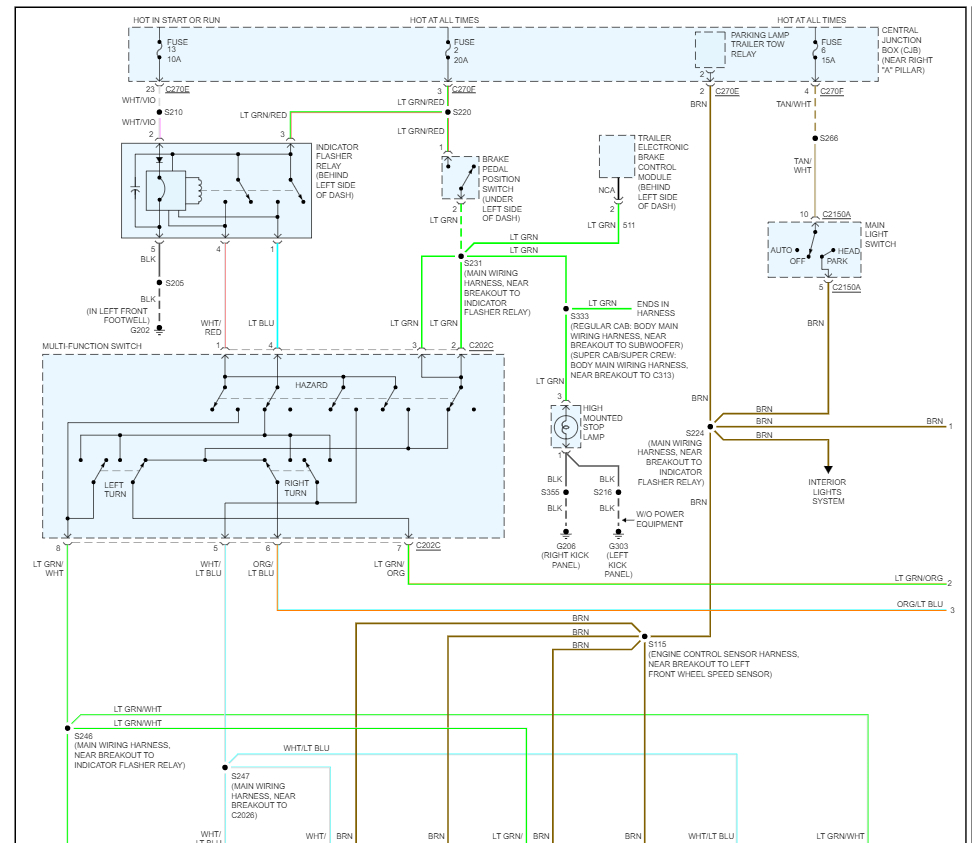

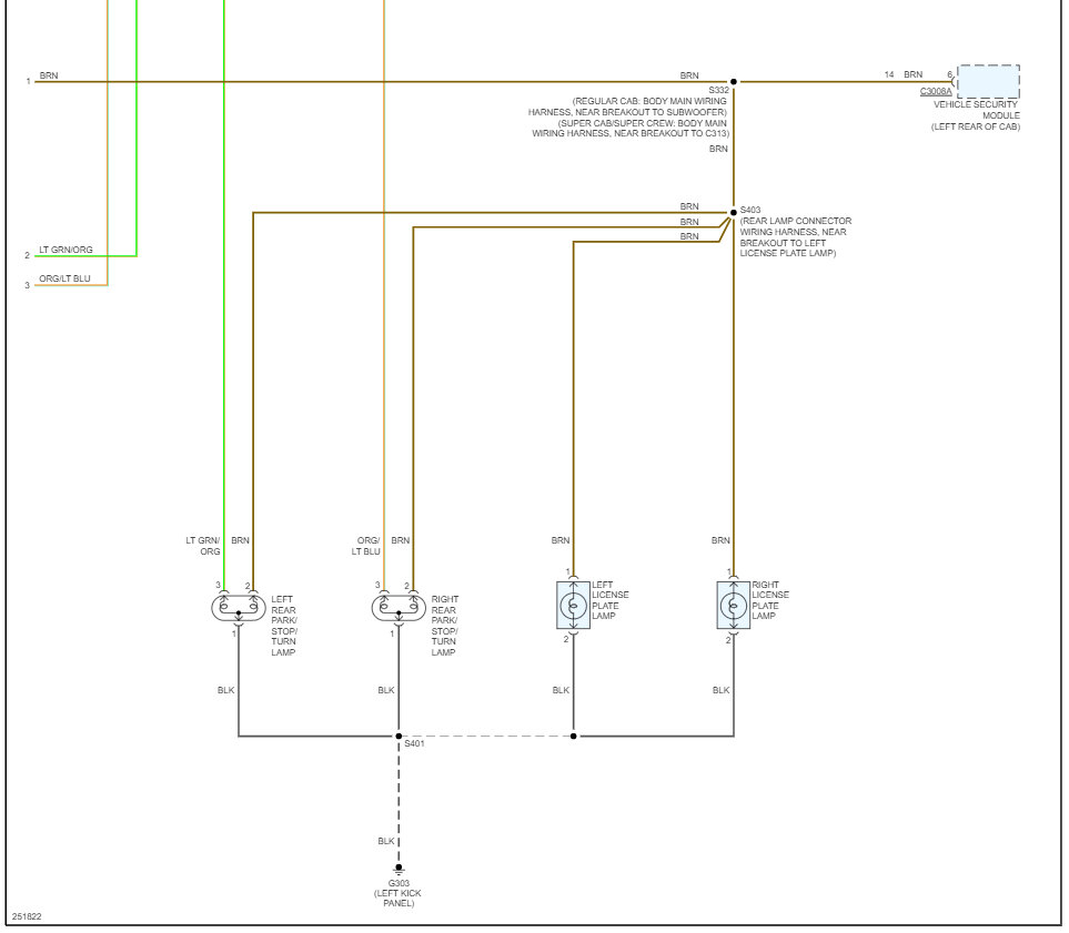

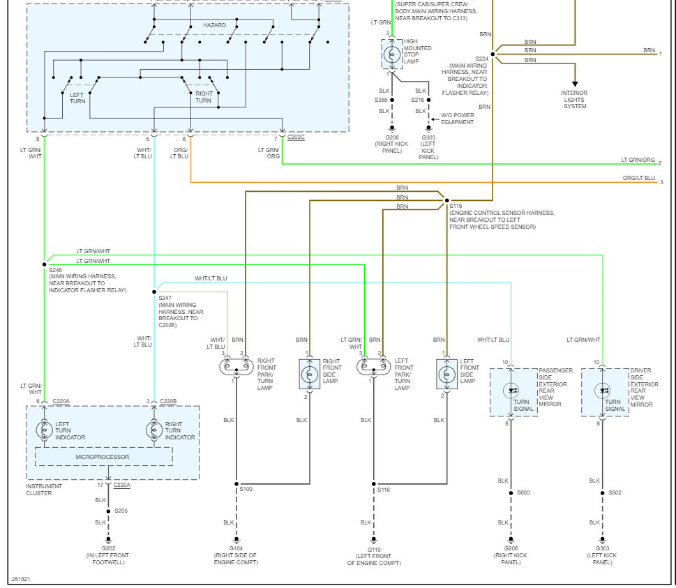

The left rear parking lights are inop. I request a wiring diagram. Thank you.
May 13, 2023 at 10:33 AM
Experienced Mechanic
55,616 POSTS
Sure, here is a guide that can help as well, and I have included a guide to help you test the connections.
https://www.2carpros.com/articles/no-tail-lights-exterior-running-lights-tail-lights-out
