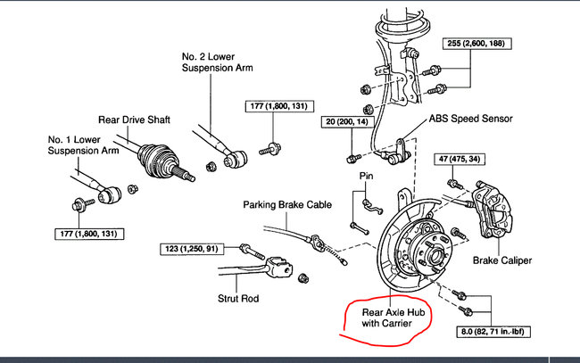

My problem is the left rear axle carrier bushing,is got a lot of slick in the bushing. Lexus wants to sell the whole knuckle.I only need the bushing,can't seem to find one that fits. I strongly would appreciate your help.Thank you

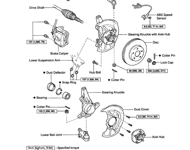

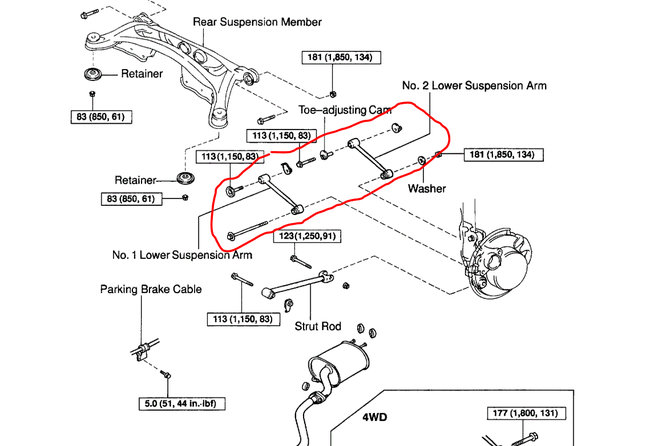

I need to confirm which part you are referring to. I attached three pics below which are exploded views of the rear suspension assembly. Do you see the part that is in question? If so, let me know which pic and part.
