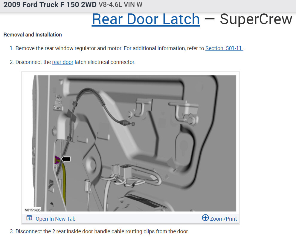

left rear door ajar light and interior lights are on draining the battery?
149,000 MILES • 4.6L • V8 • 4WD • AUTOMATIC
TIM.HENDERSON
Pulled the fuse for this, went off, a week later tried to start, drained battery, changed battery fired right up, a week later battery drained again?
Dec 27, 2023 at 9:28 PM
  • 55,661 POSTS

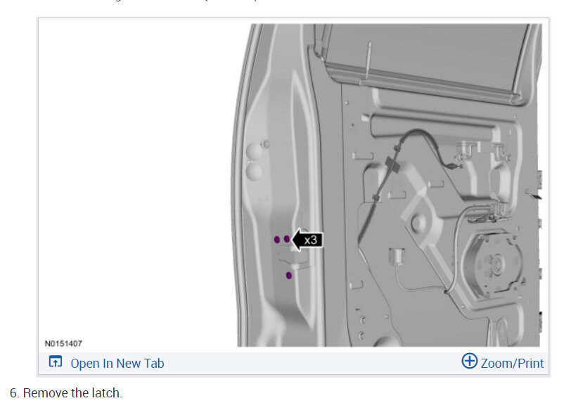

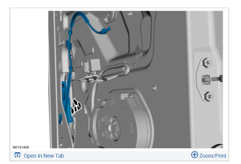

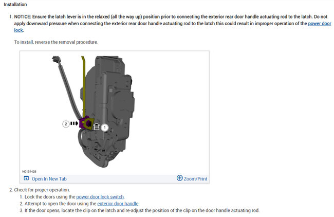

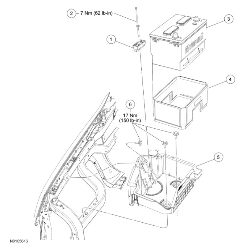

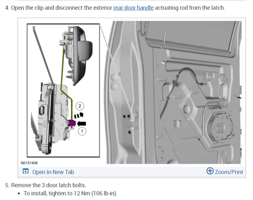

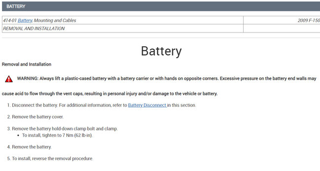

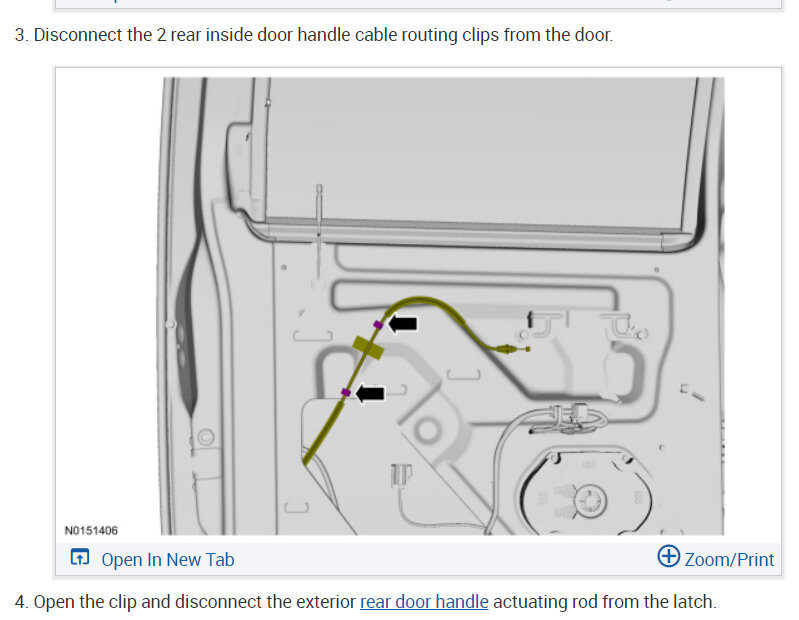

Yes, if one of the doors remains open it can drain the battery down. What happens is the micro switch inside the latch goes bad and makes the BCM think the door is still open. Also, you may have a bad battery, can I ask how old it is? This guide can help us load test the battery or you can remove it and take it to the auto parts store:
Here is how to change out the door latch to help stop the drain. Also, I have included a generic guide on how to swap out the battery.
https://www.2carpros.com/articles/how-to-replace-a-car-battery
Check out the images (below). Let us know how it goes.
