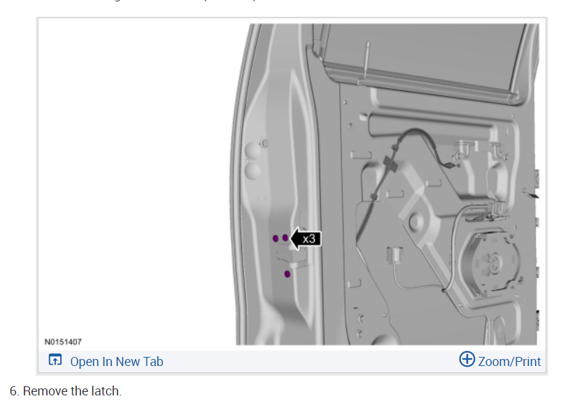

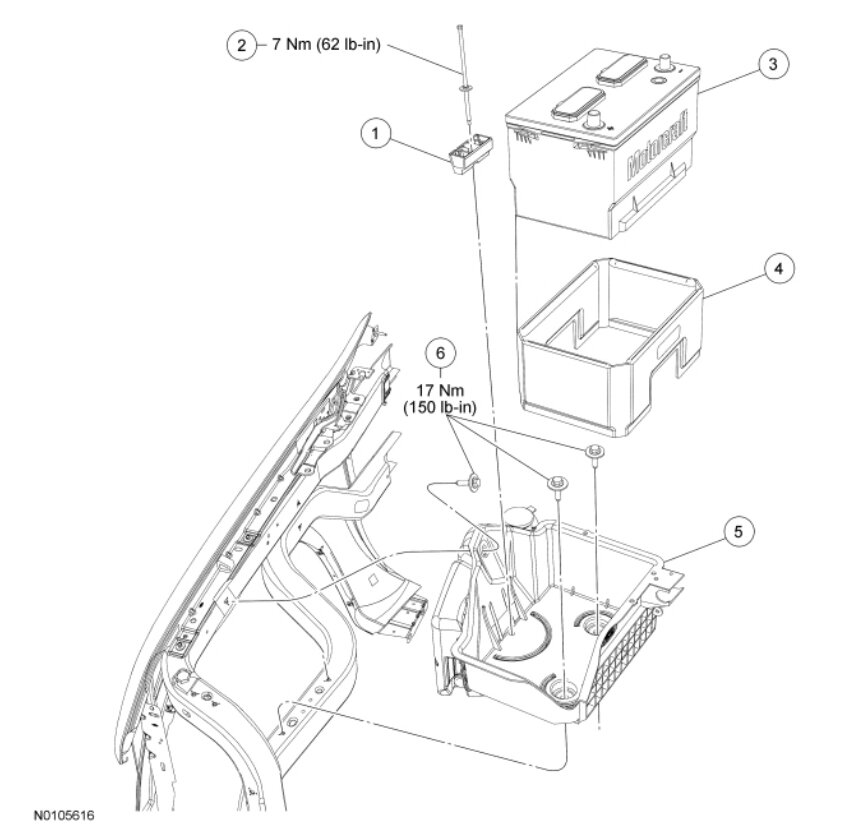

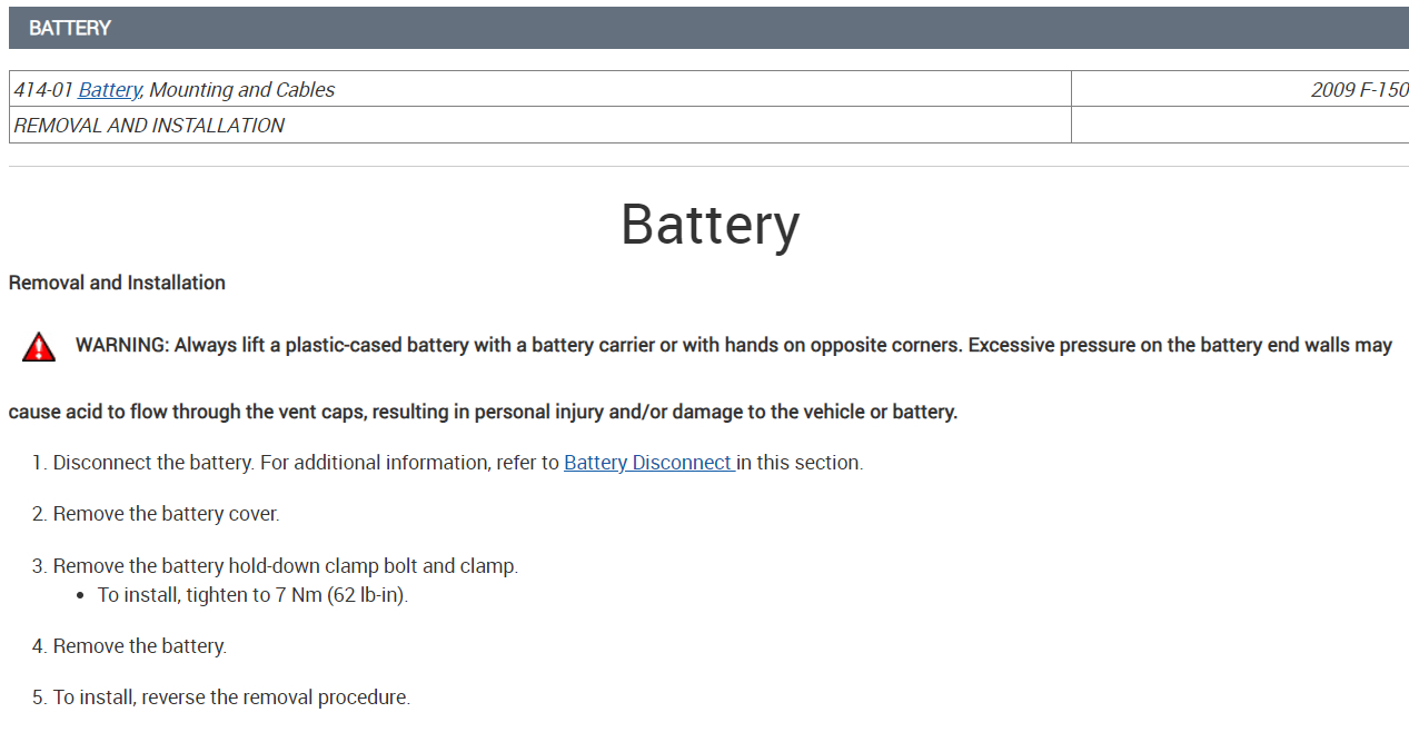

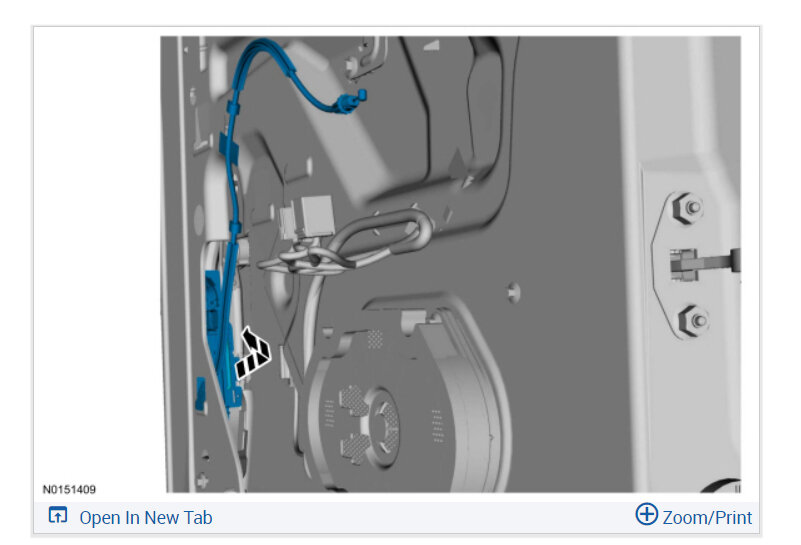

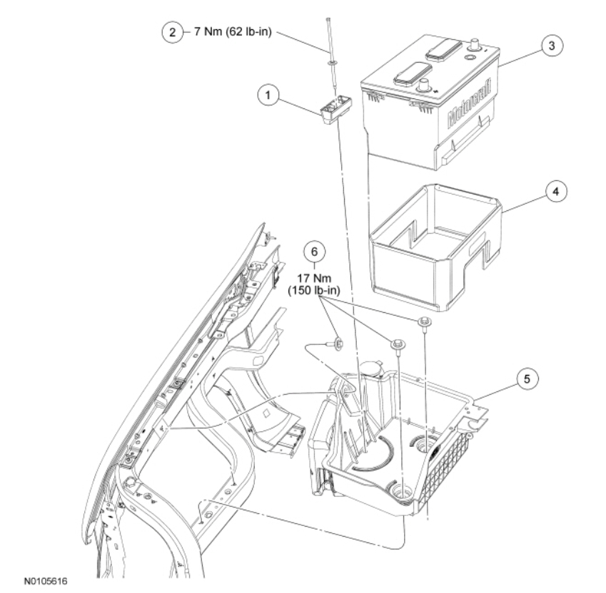

Yes, if one of the doors remains open it can drain the battery down. What happens is the micro switch inside the latch goes bad and makes the BCM think the door is still open. Also, you may have a bad battery, can I ask how old it is? This guide can help us load test the battery or you can remove it and take it to the auto parts store:

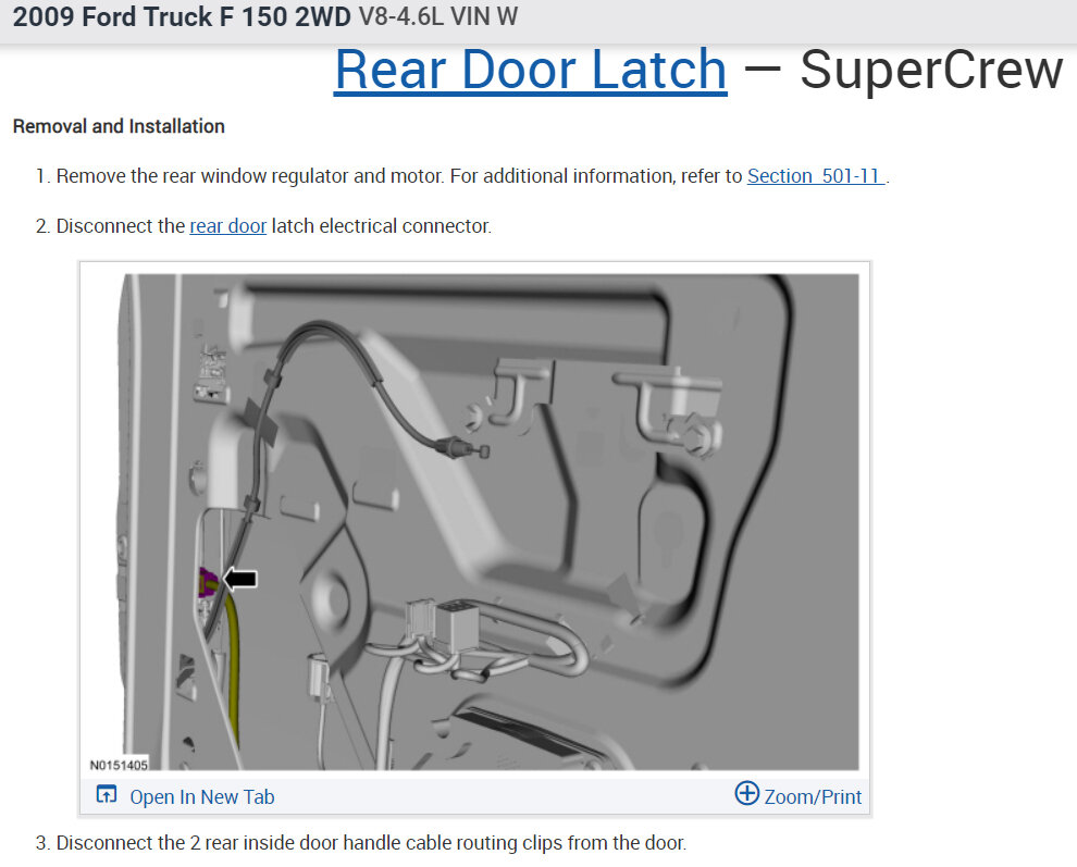

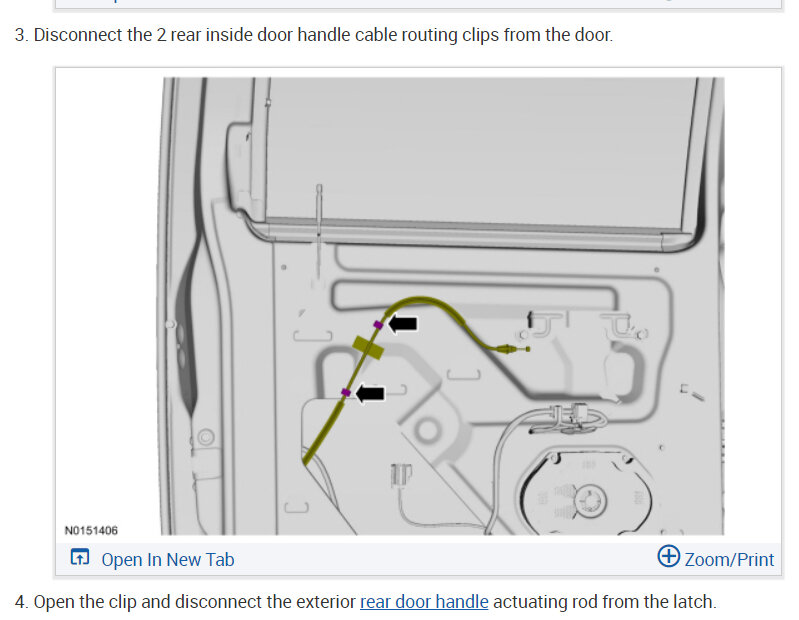

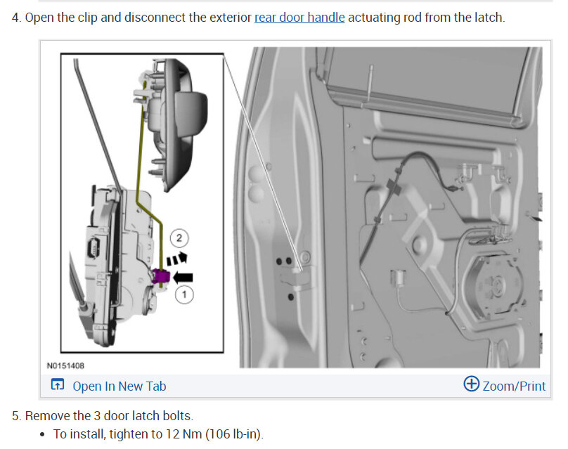

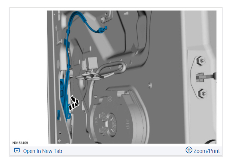

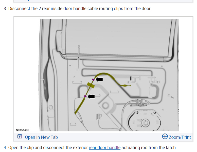

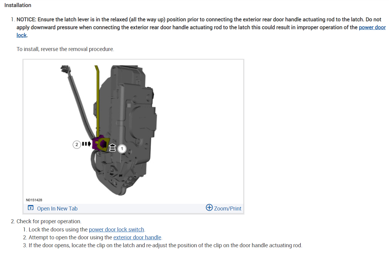

Here is how to change out the door latch to help stop the drain. Also, I have included a generic guide on how to swap out the battery.
https://www.2carpros.com/articles/how-to-replace-a-car-battery
