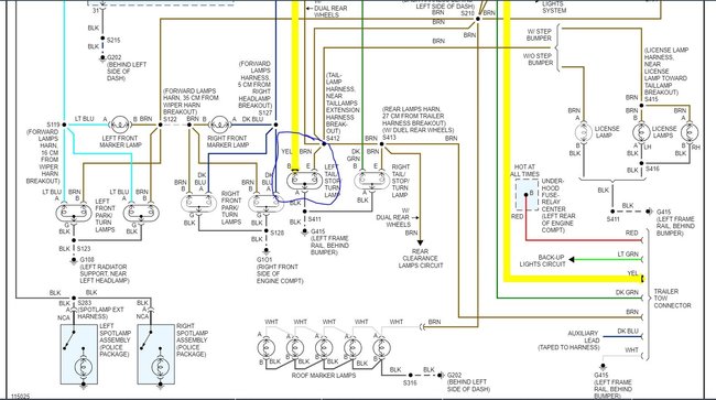

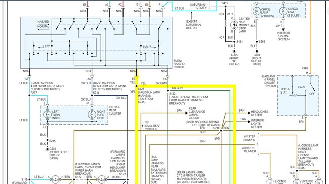

When I turn on the left blinker, inside flashes fast, front left signal is flashing faster than usual. Both the brake lights and turn signal on back left side do not work. The bulbs were checked, and they are fine.

I would replace the bulb as a start. It can look good but still be bad.
https://www.2carpros.com/articles/turn-signal-bulb-replacement
I would also check for power to the socket while someone pushes on the brake pedal to see if power is being delivered to the socket.
