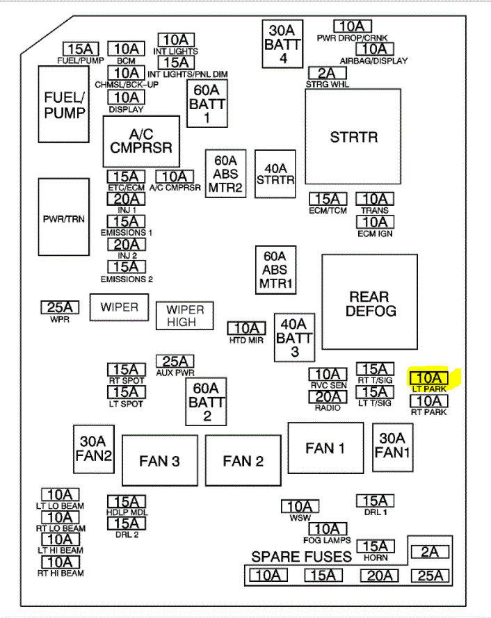

The left park doesn't work, turn signal works four ways work. I changed the bulb and the harness. when you turn on the lights the left one will not come on. where do i start to check for the short?
Nov 13, 2021 at 6:51 AM
  • 110,244 POSTS
The left parking lights have a dedicated fuse. Have you checked the fuse? It is located in the under-hood fuse box. I highlighted the fuse in pic 1 below.
When checking that fuse, confirm the fuse is good and also make sure there is power to and from it. Here is a link you may find helpful:

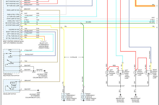

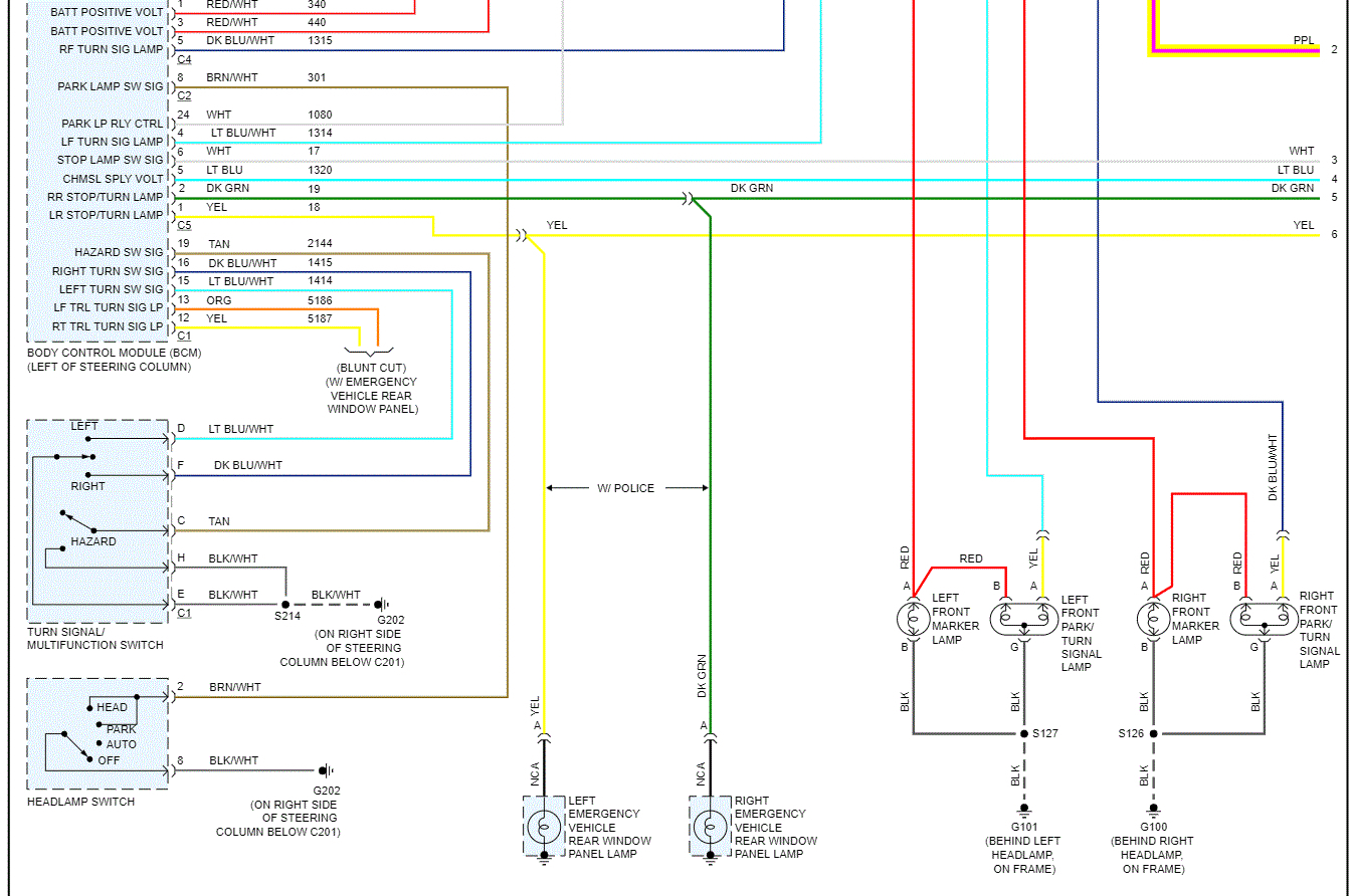

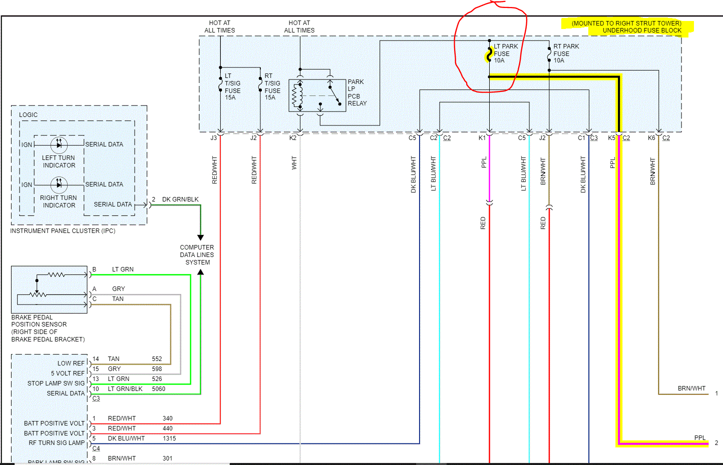

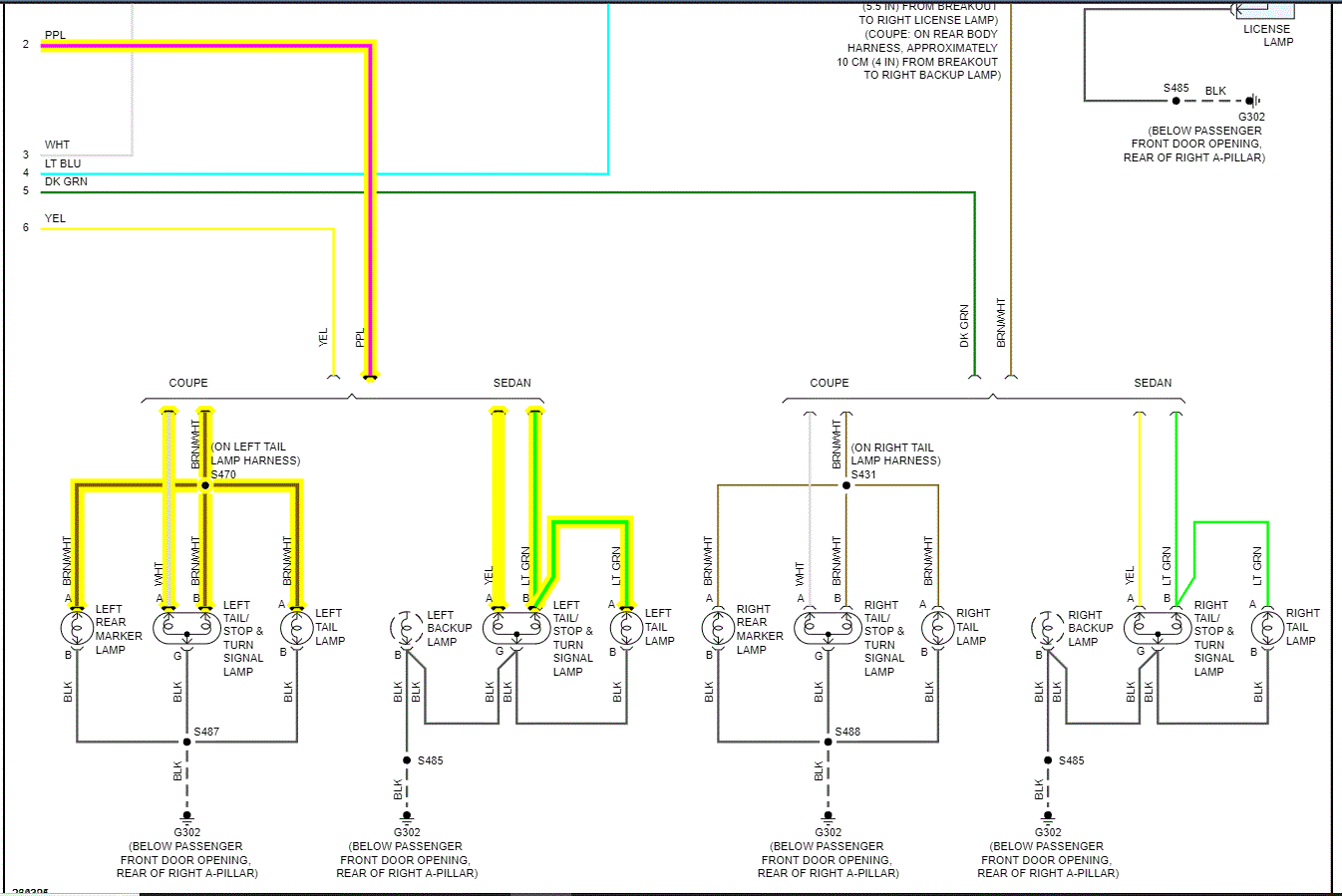

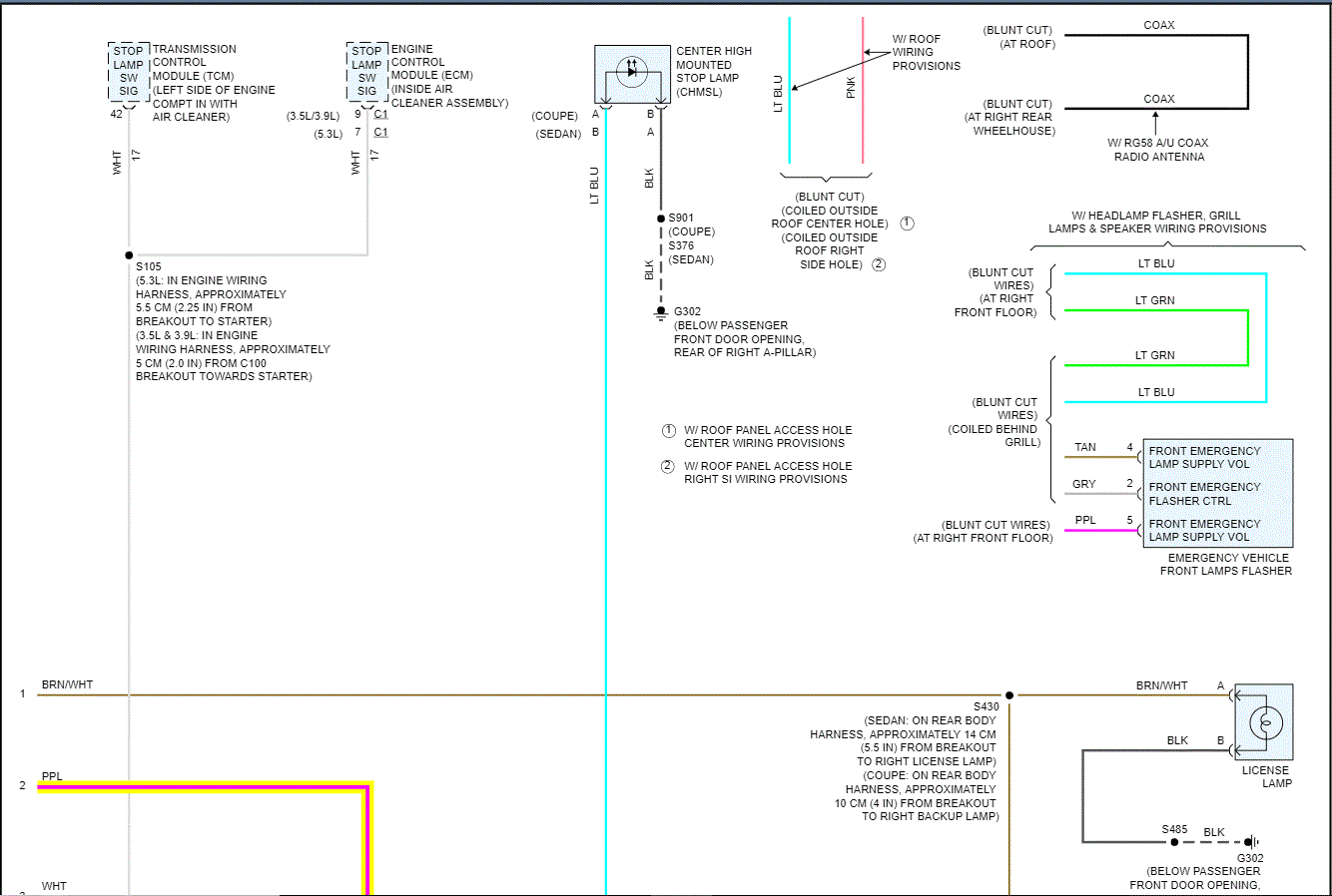

The remaining pics show the wiring schematics. I highlighted the wires for the left rear light. You can use these as a guide.
See pics below. Note: The wiring schematics had to be cut in half to make them readable for you. I did overlap them so you can follow from one to the next.

Thanks, you guys are the best I needed the wire schematic, I'm going out to check the wires. If I find the problem. Will let you know. Thanks
