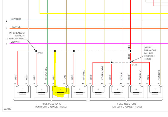

I left the key on for 3 days. The battery was drained, so I jump started it. Now it is running rough and has several random misfires. It won't go over 3,000 RPMs in neutral. I have tried resetting the PCM, but it doesn't help it. It ran fine before I left the key on.

If you look below, I attached the injector schematic. Note that each injector has a red wire. That is the power supply. That is the wire on the injector to check first when the key is in the run position. It should have 12v constant. If it does, then we need to check if the PCM is providing a ground path.
To do this, disconnect the injector connector. Cylinder 2 will have a red wire and also a white wire. Take a test light and connect the alligator clip to the positive battery terminal. On the opposite end of the test light, touch the white wire. Do this while a helper cranks the engine. If the PCM is providing a ground path, the light will flash on and off.

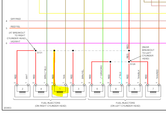

The idea that it has a lean mixture issue leads me to believe the injector is bad. If it was a vacuum leak, which is very common, it would likely be a random cylinder misfire code. The same if it was a fuel pressure issue.
Here is what to do. Locate the cylinder 1 fuel injector and disconnect the electrical connector. It will have two wires, one is red and the other tan. Using a test lamp, check the red wire for voltage with the key in the run position. It should have 12v constantly with the key on. If it does, then do this.
Take the alligator clip of the test lamp and attach it to the battery + terminal. Probe the tan wire with the light. At this point, it should not light. Have a helper crank the engine. If we are getting a ground path from the PCM, the lamp should flash.
Note that all injectors get power from the same place, so it isn't a lack of power, but it may be lost at that one injector.
Let me know what you find.
See pic below.
