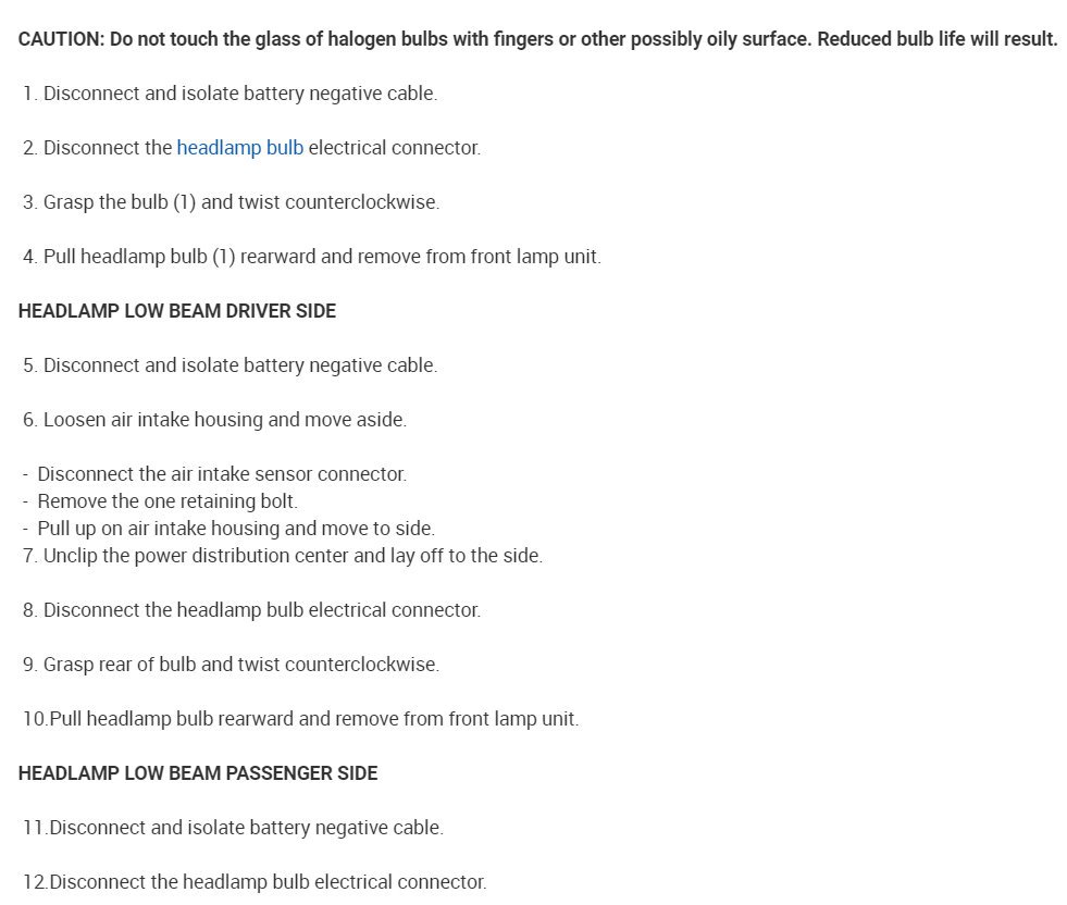

The high beam on the left doesn't work, I'm sure the bulb isn't broken. what's the problem?
Jul 31, 2022 at 5:58 PM
  • 55,562 POSTS

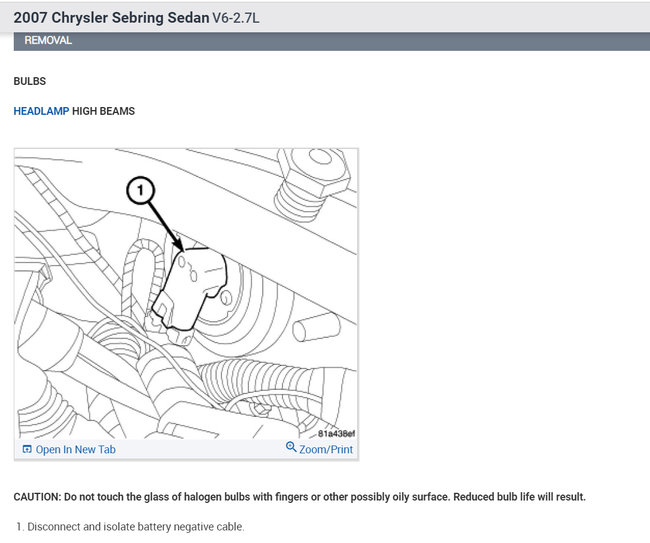

Chances are the bulb is no good. here are instructions in the diagrams below on how to change out the headlight bulb. Here is a video of the job being done on a similar car, it should help as well:

I changed the bulb, and it still doesn't work. I have a spare TIPM fuse box to replace the high beam problem perfectly solved.
