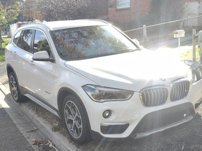

Hi
Wondering if possible can get workshop manuel pictures of the wheel hub and steering assembly and parts list FOR the left passenger side (AU) for a
BMW X1 F48 2016 petrol 2.0L turbo sdrive?
Thanks

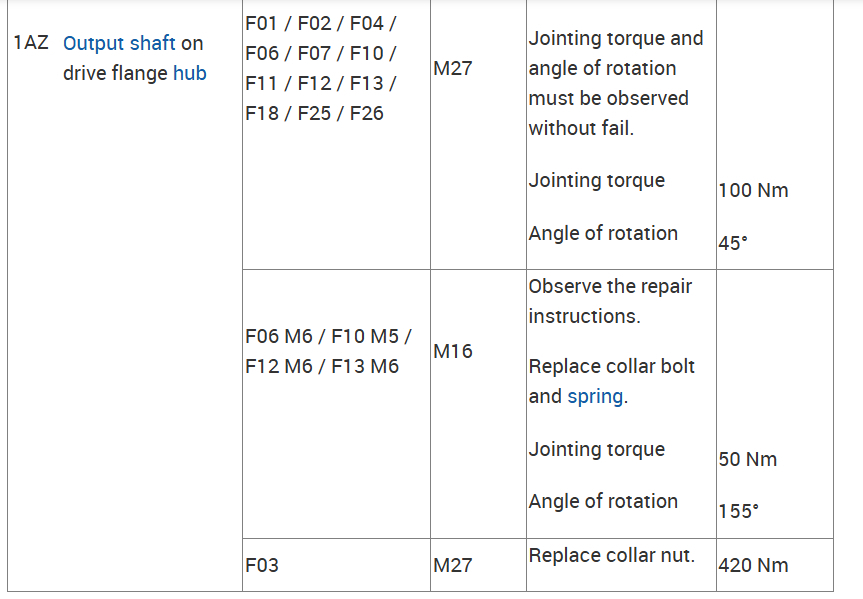

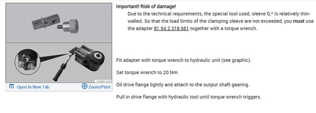

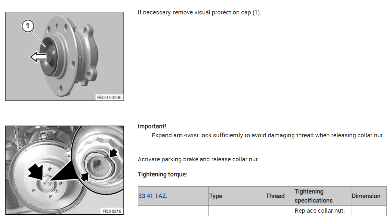

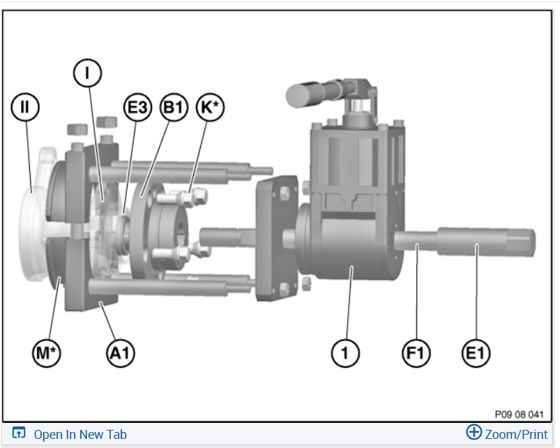

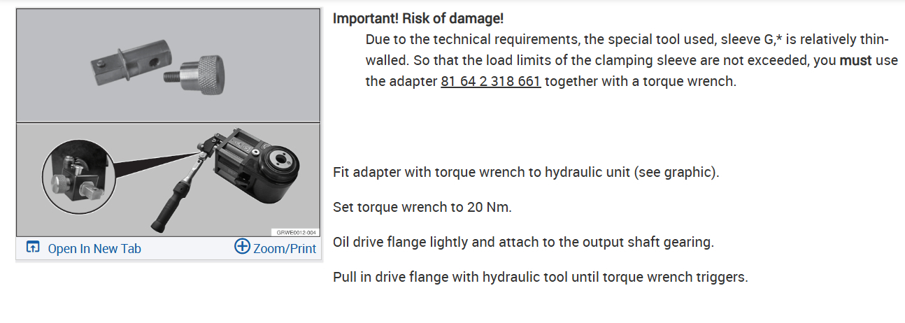

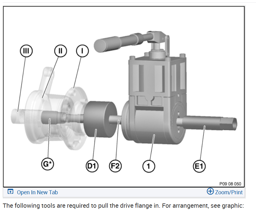

Yep I got you covered, here is the what the workshop manual has to say about replacing the hub, please start a new question for the steering part of the repair. Also is this an AWD or FWD? I don't think it mattes, here is what they show to replace the front bearing hub.
Aug 13, 2026 at 8:33 AM
  • 55,770 POSTS
Here are the images
