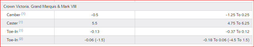

Yes! Make sure you do the driver side as well and when finished then do the alignment! Do all the work then you can be be sure everything will be even. I've attached the alignment specifications for your car when ready.The left hand specifications are preferred and the right hand is within range. Hope this helps and thanks again for using 2CarPros.
