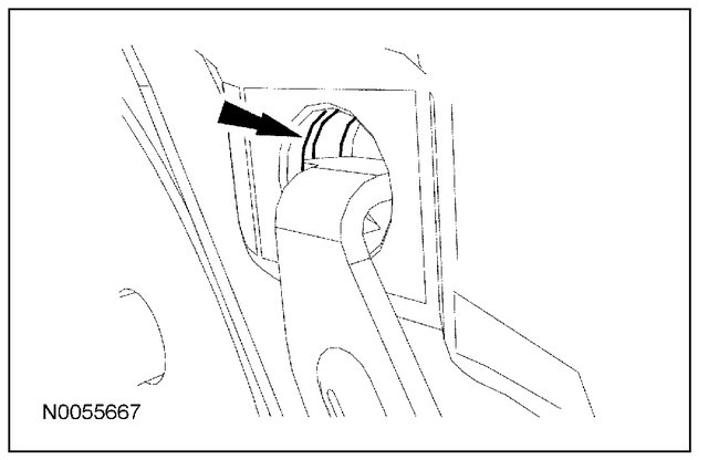

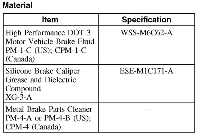

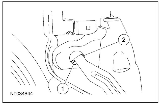

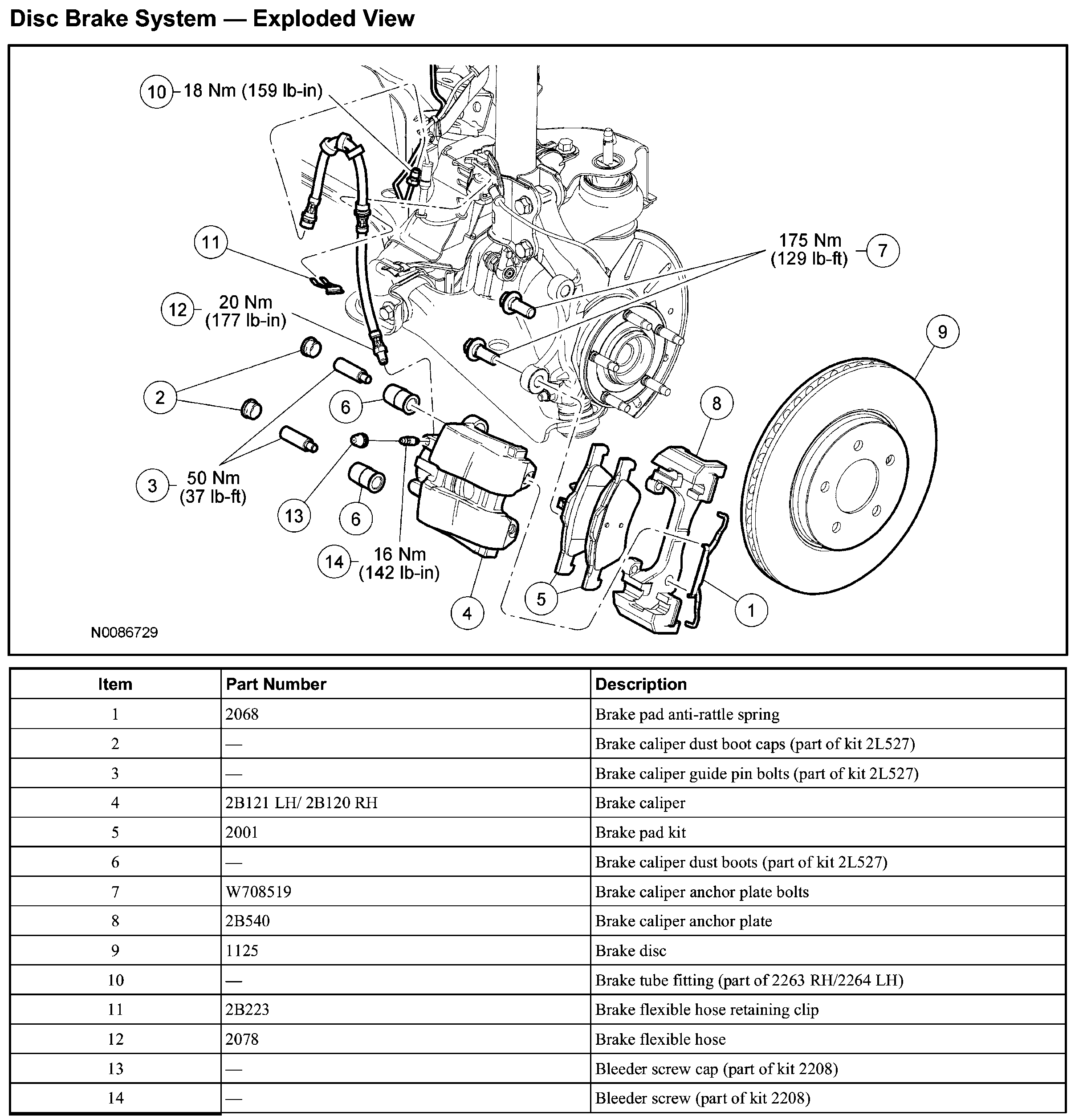

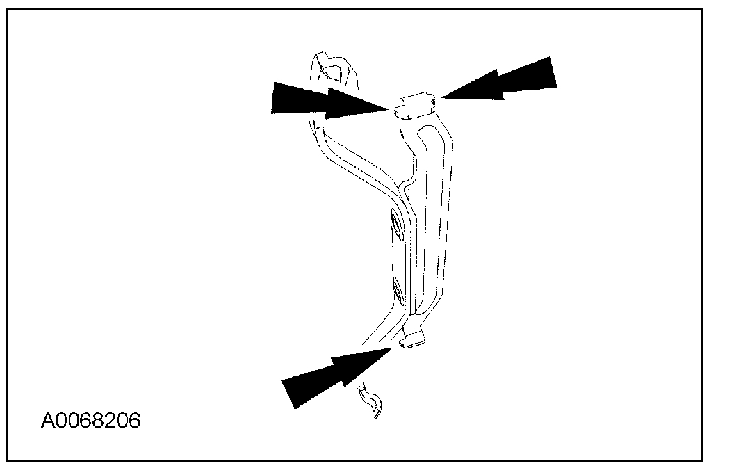

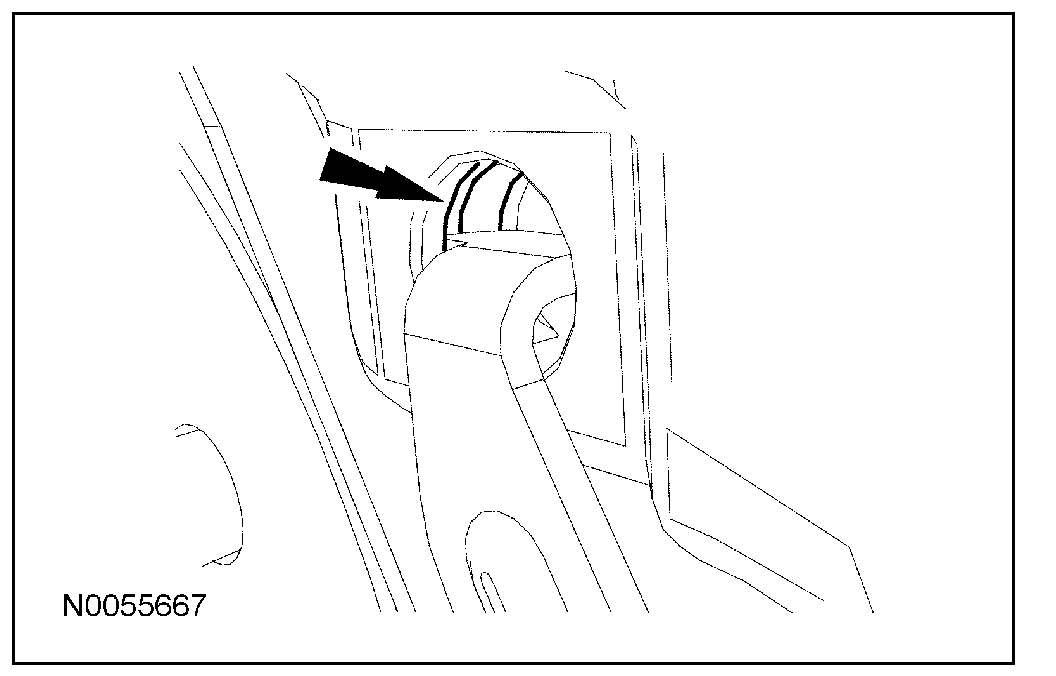

I put new front rotors on today and everything went fine. I drove it only 2.2 miles to the store and back after getting it all together and the left front brake rotor is incredibly hot and I can feel it drag when driving. The right side is perfectly fine. I need to service the caliper slides and do the brakes at the same time can you help me?

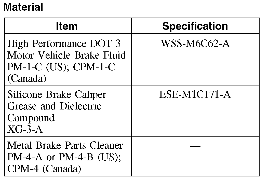

Brake Pads
Material
Material
pic 1
Disc Brake System - Exploded View
pic 2

3. CAUTION: If the brake pad anti-rattle spring is to be removed, do not force the spring off the brake caliper or damage to the spring can occur.
CAUTION: Do not use any tools to remove the spring, use hand force only. Do not use excessive force or damage to the spring can occur.
NOTE: The LH side brake pad anti-rattle spring must be installed with the 2-tabbed end in the upper brake caliper cavity.

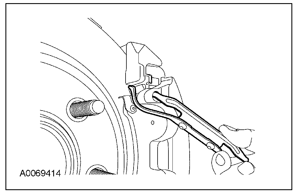

For the LH brake caliper, release the lower portion of the brake pad anti-rattle spring.
^ Apply force to the center of the spring and pull outward at the bottom of the spring to remove it from the lower brake caliper cavity.
pic 3

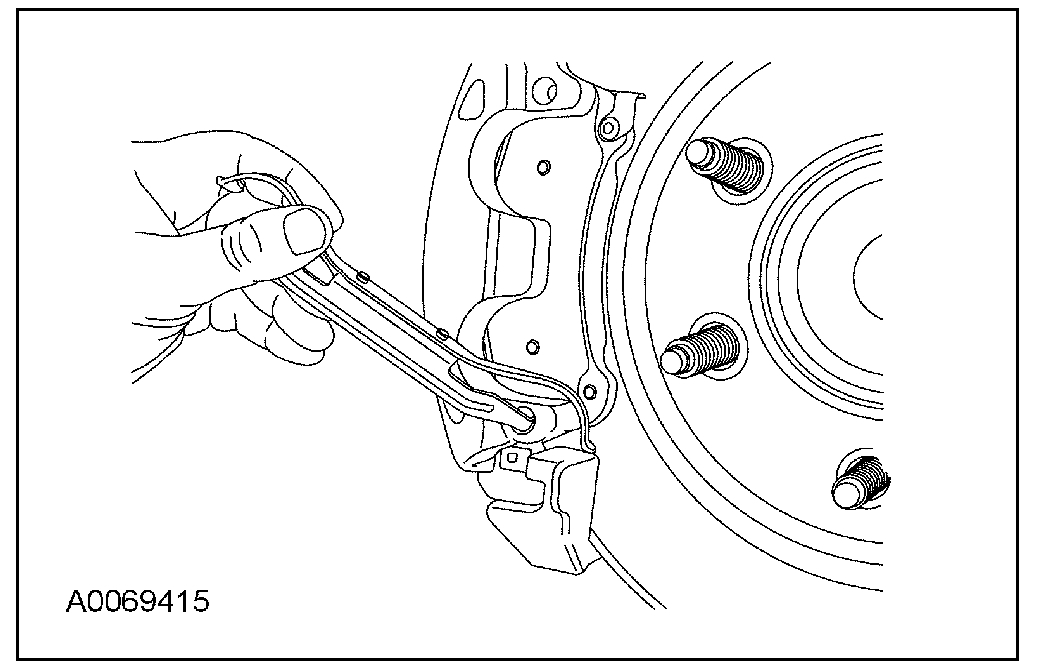

4. Rotate the spring upward and remove it from the brake caliper.

5. NOTE: The RH side brake pad anti-rattle spring must be installed with the 2-tabbed end in the lower brake caliper cavity.
For the RH brake caliper, release the upper portion of the brake pad anti-rattle spring.
^ Apply force to the center of the spring and pull outward at the top of the spring to remove it from the upper brake caliper cavity.
6. Rotate the spring downward and remove it from the brake caliper.
pic 5

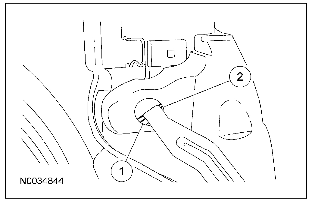

7. CAUTION: Do not allow the caliper to hang from the brake hose or damage to the hose can occur.
Remove the 2 guide pin bushing caps and the 2 brake caliper guide pin bolts, position the caliper aside.
^ Support the caliper using mechanic's wire.

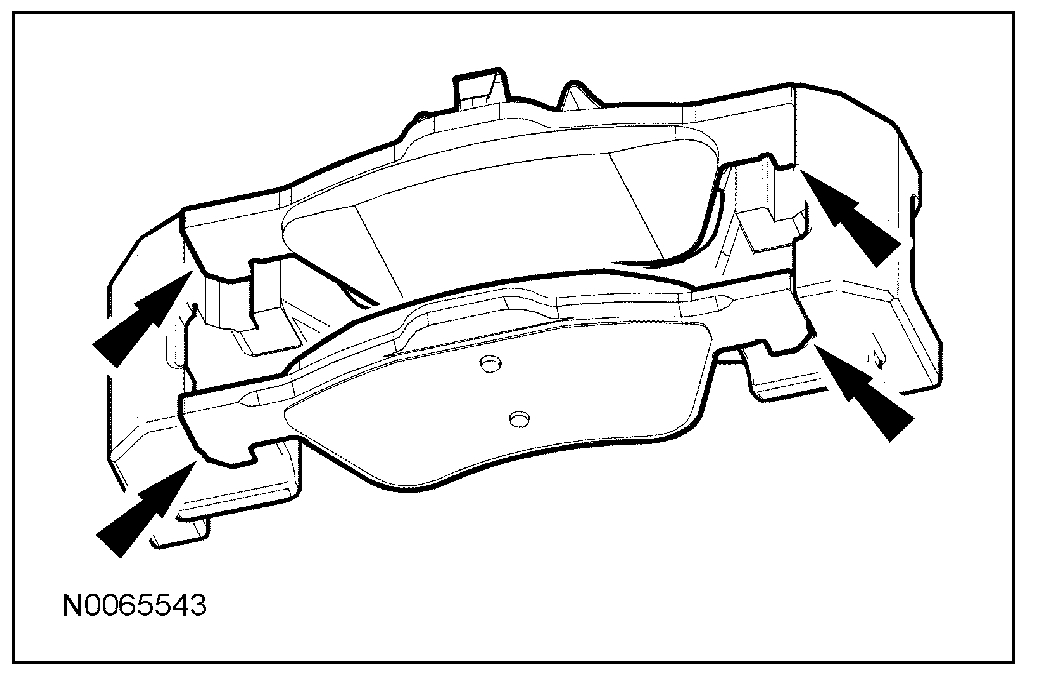

1. Clean, dry and inspect the brake caliper anchor plate. Apply a light coat of specified lubricant to the 4 brake pad contact points on the anchor plate.
pic 6

3. Install the 2 brake caliper guide pin bolts and the 2 bushing caps.
^ Tighten the bolts to 50 Nm (37 lb-ft).
