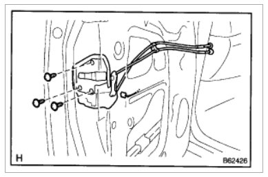

Left door (driver) not closing properly.
Mar 27, 2018 at 1:54 AM
RONALD WOODS
  • 12 POSTS
I have to slam the door several times to make sure it closes correctly. When I try and close the door it leaves a gap.
Mar 28, 2018 at 4:38 AM
  • 55,447 POSTS

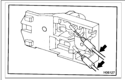

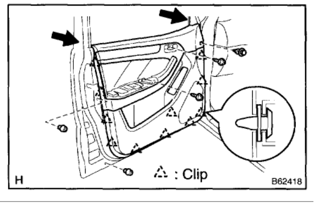

This sounds like the latch needs to be replaced you will need to remove the door panel.
https://www.2carpros.com/articles/door-panel-removal
This guide will give you an idea. Here are diagrams to show you how to do the job.
