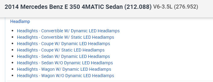

I just went to the wiring schematics to determine what could be the issue. I found several options to pick from. Could you take a look at the pic below and let me know which fits your vehicle? The schematics are different.
Let me know. Also, let me know if you have checked the bulb and if there is power to the bulb.
Mar 4, 2024 at 11:27 AM
GUGA TODUA
My car is a Coupe. I don't know whether it is static or dynamic.
Looks static because LEDs are always on.

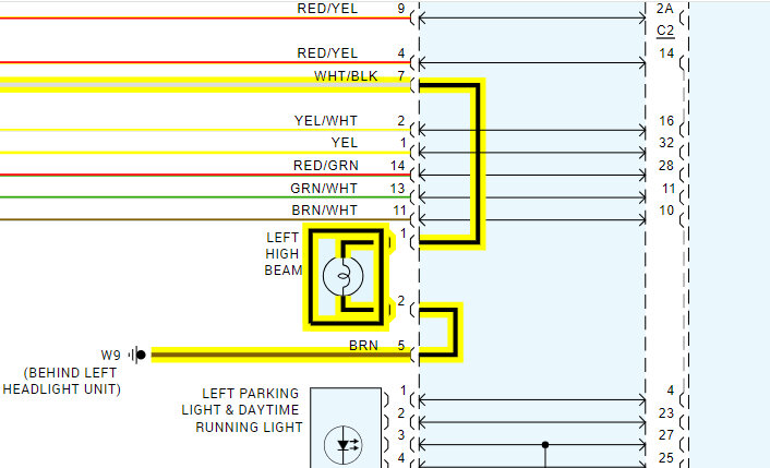

What I need you to do is this. At the headlamp assembly, there will be a white wire with a black tracer. I need you to locate that wire.
Turn the high beam on and use a test light or voltmeter, see if there is power present. If it has power, locate the brown wire, and check it for continuity to ground. If you have power and ground, the light itself is the likely problem.
Try this and let me know what you find.
See pic below.
