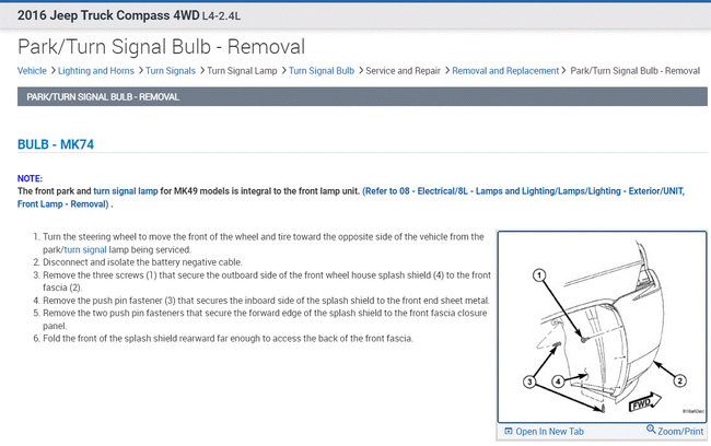

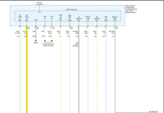

Okay, it's the right front (passenger side) only. Here is how this works. Power is sent via what is called a totally integrated power module (TIPM) to the signal lamp and the headlamps.
First, note if the signal light turns on when both the high beam and low beam are on. If it is only one, that will help narrow things down. If it is only one, let me know which one.

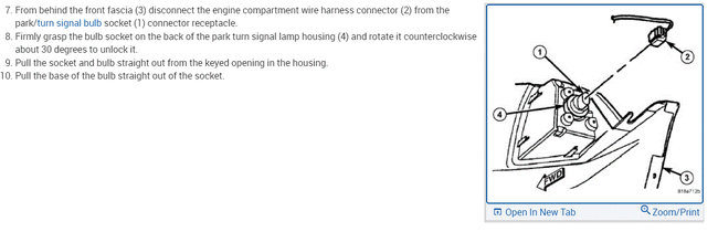

Next, I need you to check the wiring at the front headlamp assembly to see if anything has crossed or there is evidence of light socket damage or wiring damage.
To access the wiring for the signal lamp, follow the directions in pics 1 and 2. You access it from inside the fender, a plastic liner with an access location.

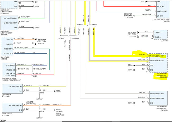

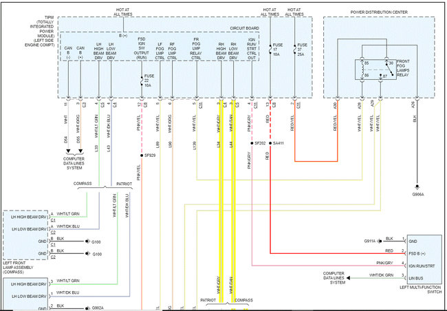

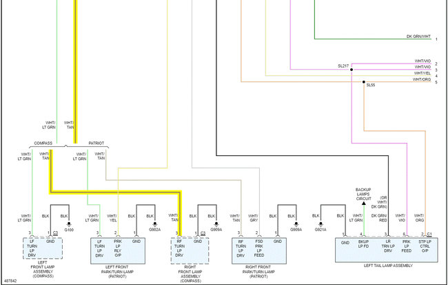

Now, if you look at pics 3 and 4, that is the wiring for the signal lamp. Pics 5 and 6 are the headlamp wiring. Note that the power for both is from the TIPM. If the wiring is good at the sockets, there is no evidence of a short, and nothing appears corroded or damaged, chances are the problem is back at the TIPM, which is basically the large fuse box under the hood.
The TIPMs on these vehicles have a history of the connector pins breaking, corroding, and causing issues. The cause is due to there being so many pins that are extremely small and oftentimes, non-repairable. So, we will need to check. (That is the last resort).
Let's start simple with the tests I provided. I did note that wiring to the low beam for the right side is in the same connector as the signal for the right front. The right rear is powered via a different connector.
