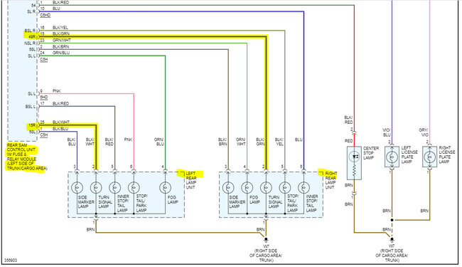

I had upgraded the rear turn signals to some Auxito LED bulbs that is equipped with CANBUS. I noticed that the right bulb works for a few seconds and then it stops and i immediately get a bulb out error on the cluster. The left bulb works with no issues, it’s just the right that’s having an issue. I thought it was the bulb, so I put another brand new bulb in and it still does the same thing. When I lock and unlock the car both bulbs work with no problem. I put the old incandescent bulb back into the right side and it works with no issues. Has anyone had this problem before?

I just went through wiring schematics and found that the left and right-side signals get power from two different pins at the SAM module (Signal Acquisition Module). If there the left power supply has a bit more resistance in the wire, that could allow the circuit to continue working. See pic below.
I feel it you would place a resister at the right rear signal lamp, that would eliminate the bulb out and failure of the right side.

The bulbs have built in CANBUS and load resistors.
