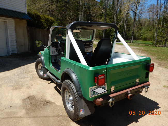

I installed LED taillights and changed both flashers for multi bulb use. I have new incandescent front parking lights. The turn signal and hazards work fine until I turn the parking lights on, then just sold light is on.
I put the original taillights back on and all works fine together. I did a fuse panel test, where I took out one fuse at a time and touched + battery with tester, it had a faint light briefly, only with hazard/stop fuse. How do I get the LED taillights to work with parking lights? do I need a relay for LED lights? suggestions?

I have assisted helping a few people using/ attempting to use LED.
Things that stick out (been a while)
Using a LED flasher
Using Load Resistors (pic 1 below)
Insuring grounds are intact, I recall screwing around forever on a "7" only to find the park light housings (to the grill) were intermittently grounding. We ended up installing clips onto the grill (see pic 2 below) to get a good ground.
You might investigate the site (pic 1) for additional information. "You Tube" might help too!

sorry reply took so long, I bought the load resistors, shipping was like 10 days, I already had a multi bulb flasher, already fixed the grounds in the front, so went for the resistors, they work, yeah !!!, now I can get an inspection sticker. I really didn't want to part with the LED tail lights, super bright even in the sun, wanted them for safety, thanks !
