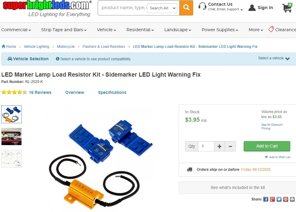

I installed LED taillights and changed both flashers for multi bulb use. I have new incandescent front parking lights. The turn signal and hazards work fine until I turn the parking lights on, then just sold light is on.
I put the original taillights back on and all works fine together. I did a fuse panel test, where I took out one fuse at a time and touched + battery with tester, it had a faint light briefly, only with hazard/stop fuse. How do I get the LED taillights to work with parking lights? do I need a relay for LED lights? suggestions?

I have assisted helping a few people using/ attempting to use LED.
Things that stick out (been a while)
Using a LED flasher
Using Load Resistors (pic 1 below)
Insuring grounds are intact, I recall screwing around forever on a "7" only to find the park light housings (to the grill) were intermittently grounding. We ended up installing clips onto the grill (see pic 2 below) to get a good ground.
You might investigate the site (pic 1) for additional information. "You Tube" might help too!

sorry reply took so long, I bought the load resistors, shipping was like 10 days, I already had a multi bulb flasher, already fixed the grounds in the front, so went for the resistors, they work, yeah !!!, now I can get an inspection sticker. I really didn't want to part with the LED tail lights, super bright even in the sun, wanted them for safety, thanks !

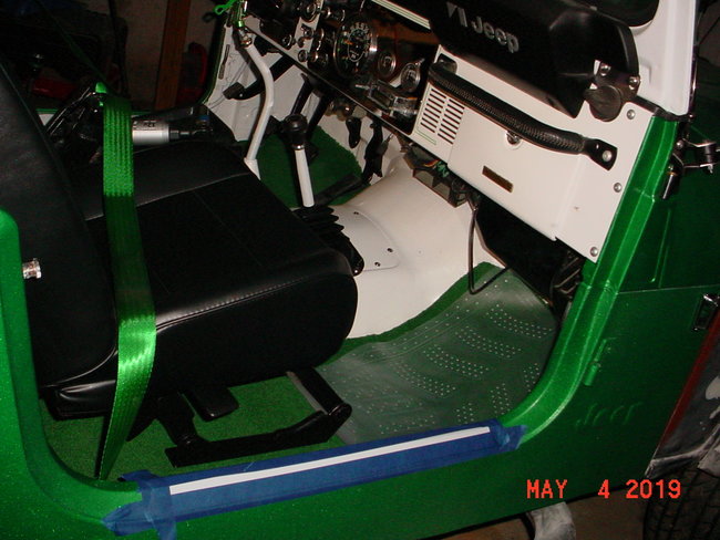

Hi, I am doing the paint myself, one section at time, I made the marine vinyl roll bar covers with green zippers, cut green carpet, custom mud flaps, and even redid the laredo dash stripes in green, oh and green seat belts :-)

That is a very nice job that you have done!
You will be very proud of him when other folks start throwing out compliments.
I'm sure you are aware of it (and will probably get it on there)
The spare tire on the rear screams "Jeep" to anyone behind you, but most of all, it comes in pretty handy when you have a flat.
