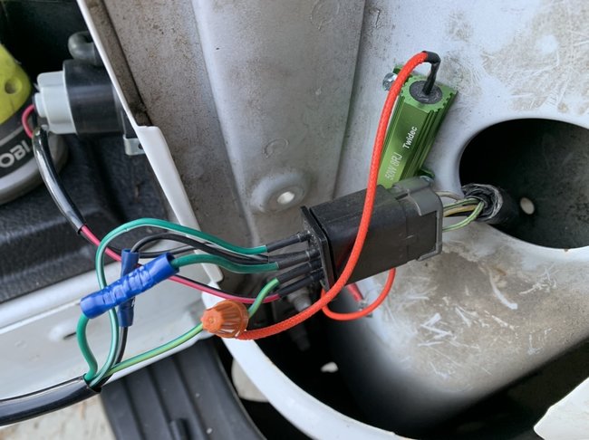

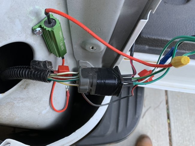

Just swapped the old rear tail light assemblies for new C-bar LED tail lights (and 3rd brake/cargo light) as part of my custom restoration. After installation, my rear blinkers started hyper flashing, brake lights didn’t work (they “strobed” when I pressed the brakes) and the “lamp out” message appeared on the dash. Running lights work fine as does the 3rd light.
After some research I installed 8ohm/50w resistors grounded to the body and connected to the blinker wire on each rear tail light. I tested everything with the key on “acc” and the problem appeared to be solved. That is until I cranked the truck up.
With the truck running, as soon as I press the brake, the “lamp out” lights up, brakes strobe when brake is applied, and rear blinkers don’t work. Weird thing is, the front (standard bulb) blinkers work with their normal cadence. Also, the 3rd light works properly.
I’ve read that this generation of truck, particularly 02-05, is very persnickety when it comes to electrical changes.
I’m at a loss as to what to try next. I love the look of these tail lights but need them to work properly.
Any suggestions?

I haven’t made any changes to the existing wiring rear light wiring other than installing the resistors. I’ve attached a couple of pics so you can see how it’s wired. You’ll notice that I added a jumper across the ground on the driver’s side. I had a poor connection on this side.

I swapped the front incandescent blinker bulbs to LEDs. Got rapid flash again so I installed resistors (6Ohm/50watt) at each front blinker. That settled the rapid flash but didn’t do anything for the “lamp out” or strobing at the rear brakes.
It did get me thinking and I noticed a pattern to the rear brake strobing issue. It started strobing and displaying the “lamp out” error after I left off the brake. Letting off the brake created a wattage drop that the computer detected as a bulb out. On stock taillights, this model truck has 2 bulbs on each side drawing energy when the brakes are pressed. So I added an 8Ohm/50watt resistor to each rear brake light wire.
Voila! No strobing tail lights and no more “bulb out” warning light. Going to test drive it tomorrow to make sure, but I put it through multiple tests (running and not) in the garage and it never failed.
