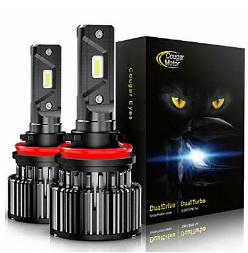

Hello, I had bought Cougar Motor LED headlights to convert my halogen projector lights to brighter LED's. This car has factory led daytime strip on the bottom. When I installed the headlights, the lights work for like 2 minutes and then after that it would start flickering. I am not getting any dashboard errors. They sent me some resistors to install which didn’t help it either and they also sent me new pair of bulbs. Both of them are doing the same thing. I have seen other cars with converted LED's that is working perfectly fine. Please help me with this.

Usually flickering is associated with a ballast but I'm sure yours does not have any. I've attached a picture below.Is this the plug and play style you installed? Hope this helps and thanks for using 2CarPros.

Yes this is the one. I bought them from Cougar directly.

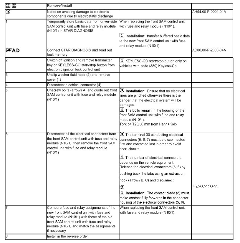

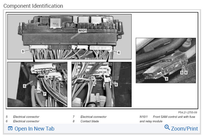

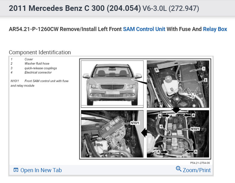

The headlight will flicker when the front SAM control unit is going out. Here is how you can replace the unit in the diagrams below. Check out the diagrams (below). Please let us know what you find.

I don’t think it’s the front SAM module as the halogen bulbs are working without any flickering issue.

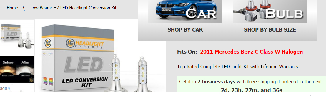

DANNY L
  • 5,648 POSTS
Hello again.
I found a site you can look at that deal with led lights. It's called Headlight Experts. I've attached a picture below.Hope this helps and thanks again for using 2CarPros.
